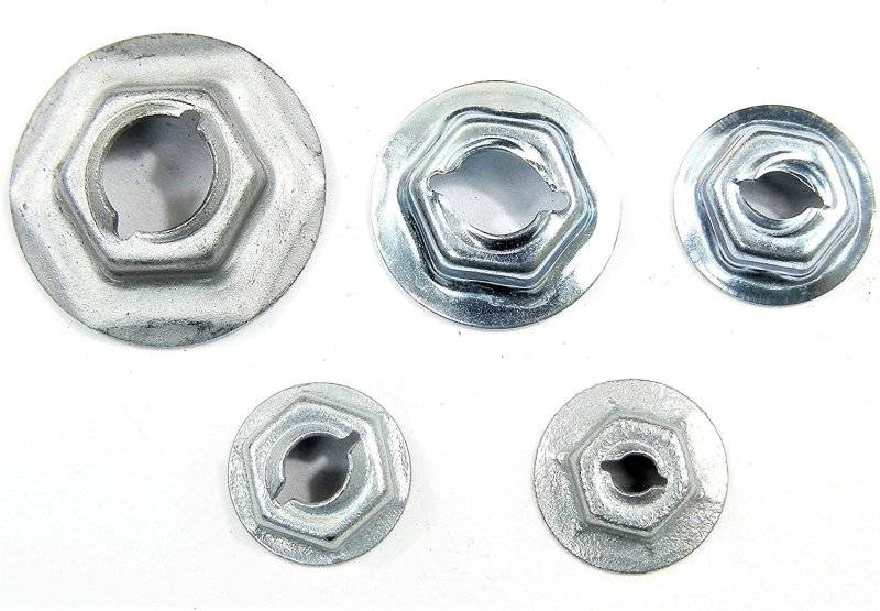

The dash pad would have threaded studs on it so there's no screws for that, and for both the pad and trim, it's sheet metal nuts like these.
