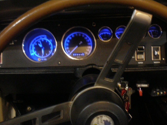

:yes: i did mine in the birdible in blue look great and i see so much better

Stuart...did you just install the LED bulbs in the twisty sockets? Looks good...except the dark spot in the speedo

only three bulbs twist in the other 7 push in the sockets (
I installed them all and beleive me when its dark you see everything fine
i'm sure white bulbs would even be brighter but i like the blue and i see everything great .
I think we need some clarification on the IP cluster bulbs. By "push in" you're referring to the flat ended bulbs that "push in" to the black sockets that then twist in to the back of the cluster.

yes sorry if i was un clear some go right into the wiring harness and three goin to those little black twist in sockets
