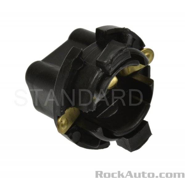

Needing a little help guys. Does anyone know the light socket part numbers for the dash on a 73 Charger? Looks like my harness must have been taken out the last time the garage was cleaned.

I don't know the part number but I do know the same part was used up into the late 80's in cars and the early 90's in trucks and vans.
standard cluster ?
5/8" twist in socket.
STANDARD MOTOR PRODUCTS S503A
PN taken from Rockauto ( $1.53 each there )
It seems a generic PN could be T5 ?
you can get packs on ebay for the same piece. Pay attention because they are in 1/2" too and also offered to fit on Charger 73, but not
I'm guessing you meant Standard cluster because is not posible to loose the sockets out of a rallye setup, unless wire, contact or socket itself gets broken
( not exactly same piece but replacement... )
Hey Guys, Thanks for the info on the sockets, much appreciated! I am to the point on installing a new Wiring Harness I need to get some ordered. Nacho - have you used the 5/8 screw in socket? If so, can you give me a little feedback? I am not the brightest guy on electricity, I am not seeing the wire for the socket?
Thanks again for the help Guys !
Socket inserts on cluster PCB on Standard clusters ( rectangular speedo ), they are not wired. Maybe that's the confusion. Check on back of your cluster.
