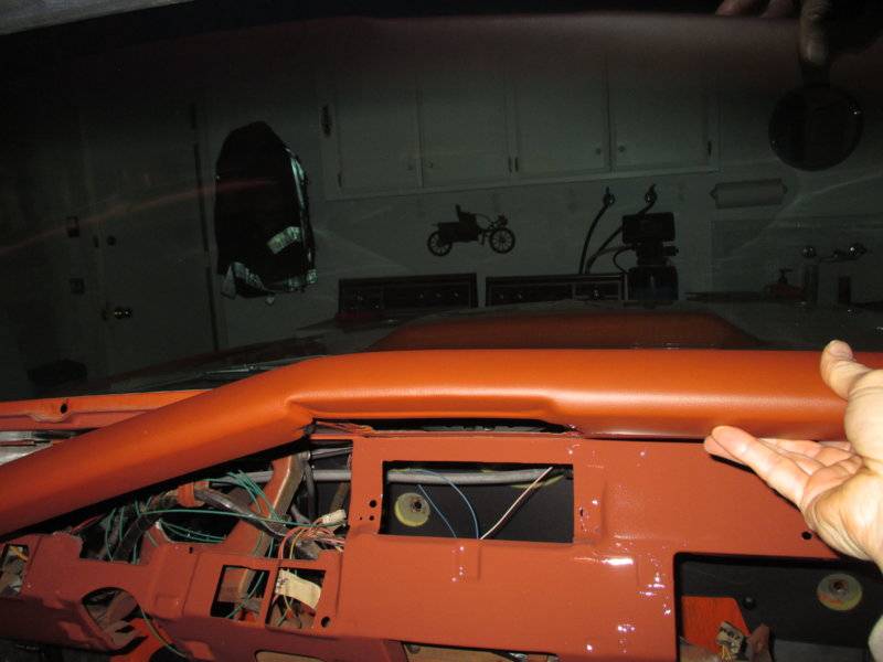

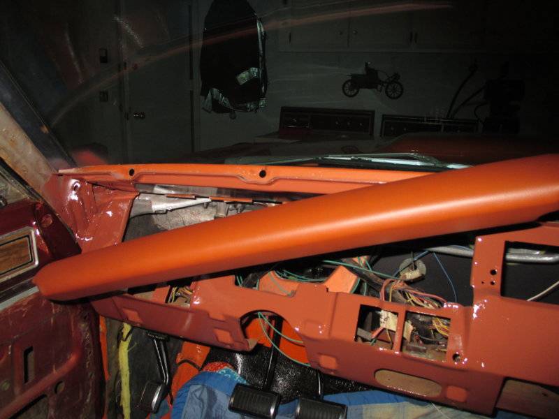

Badsport is correct. Picture of holes in dash. Was not very fun job.
You'll have to undo steering column so steering wheel lays on seat Do this when instrument is about to come out. Remove glove box liner. Then the fun part speedo cable, screws that hold instrument panel, unplug power to gauges and unplug light switch . Go to Mymopar and downjoad a service manual shows you how.
