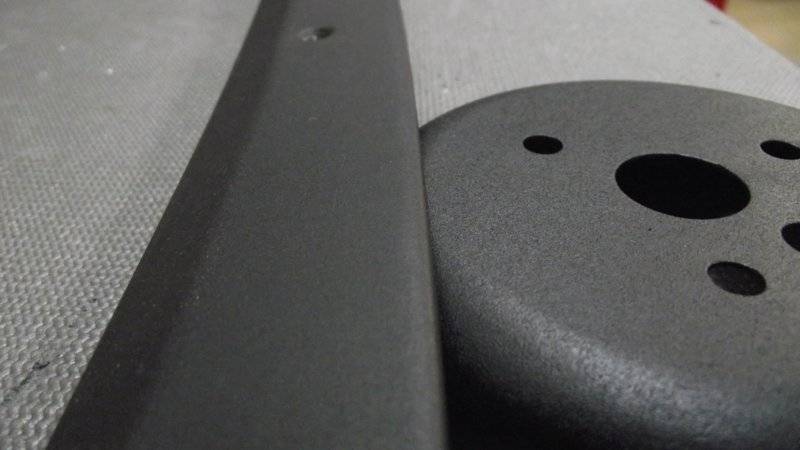

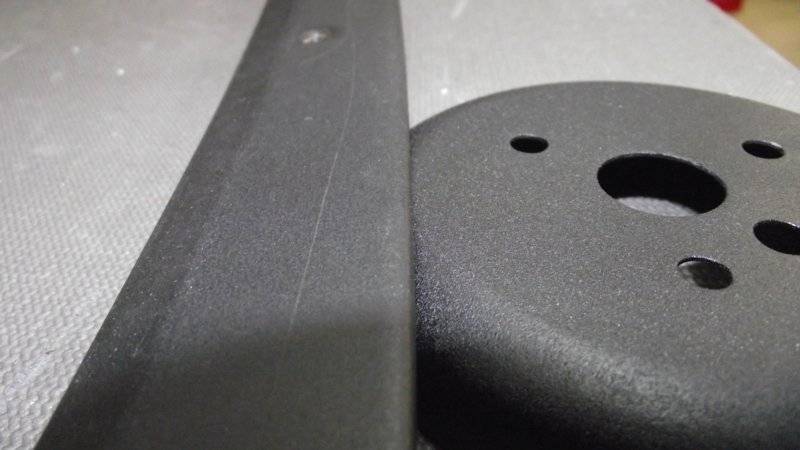

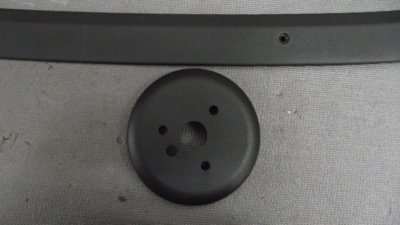

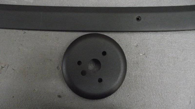

Here is an item I ded. The strip is original, the round piece is done with the rustoleum. I laid it on a little heavier than I should have but I'm ok with it. Also keep in mind its "new" so it hasn't faded or been rubbed to lose its sheen.
