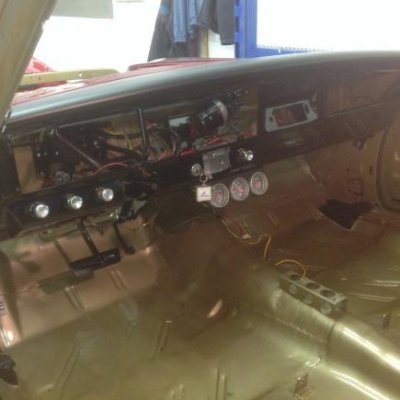

I used a matting clear on this GTX dash as well. You can sort of see it in this pic.image.jpg
