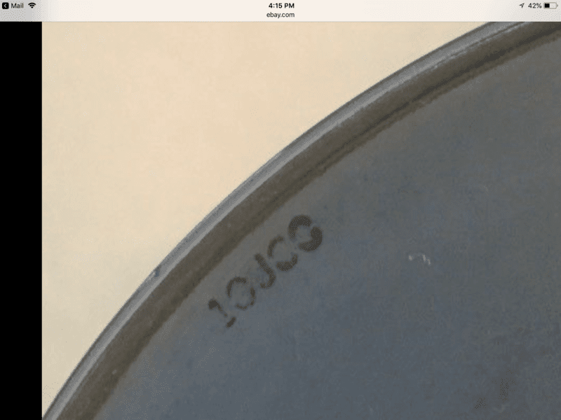

View attachment 640011 i can not find anyone that does date codes on the drivers side door mirror. Any help here
Whats up old friend?
Date coded mirrors are a PITA.....Yours looks like 10JC0.....First numbers is the month and the last is the year...So that is Oct 1970...JC is the manufacturer....
Check with Resto Rick Kreuziger at www.restorick.com. I am pretty sure that at one time, he was offering the service. You can also check with anyone that does glass etching. Some shops are able to do it with a mask and something similar to glass beading and some use a chemical means to achieve the results. Let us know what you discover as it is something that needs to be available.

I wish it was available as well.....I know Rick offered it at one time and I would like to know if he still does....

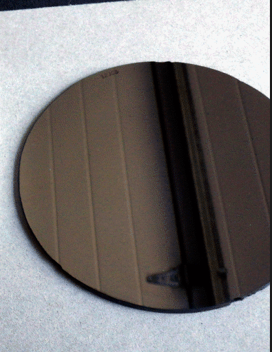

Rick no longer offers it. He only offers blanks.
Rick said, it was a blasting etchings process but he doesn’t do anymore
