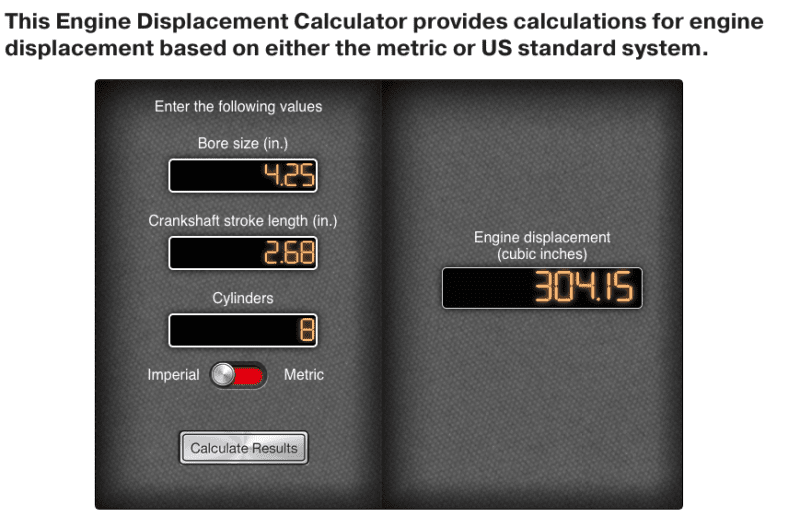

Explain please, because the distributor is in the rear of the engine shown in the video.The 305 was a destroked hemi not a small block
A 426 is a RB block, distributor in the front.I de-stroked 426 hemi would have had a very short stroke of about 2.68 inches:
