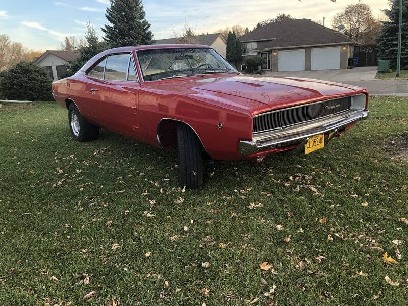

I'm taking the Charger in your Avatar pic is the car your dad bought new.
If that's it, I would definitely leave it alone. Too nice to modify to the extent to make full use of the 493.

Correct. That is my car. The charger is nice the way it is and seeing all the comments affirms the big c body will be getting the stroker. Thanks guys. Decision made. I’ll post some updates as I get into the monsterco project. Still have 3’ snow drift to melt before I can access the car.

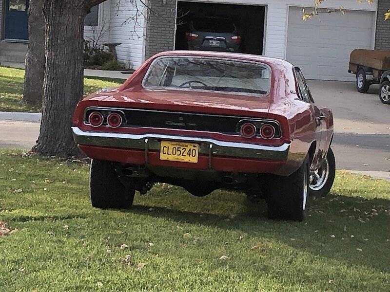

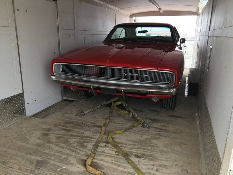

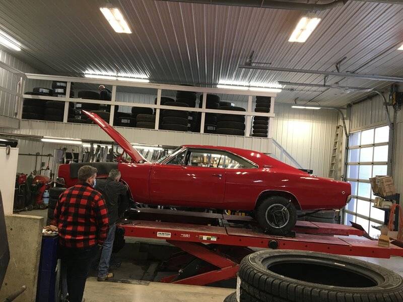

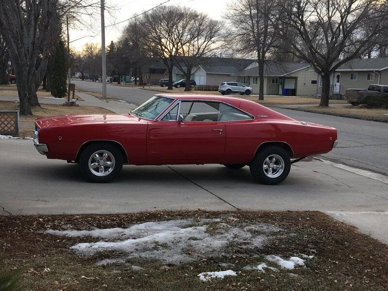

FYI I have a tunnel ram I’ll be putting on the Monaco. I have about 6 hoods for the car so I’ll clearance the hood for the engine. Here are a couple different pics of my charger for those interested.

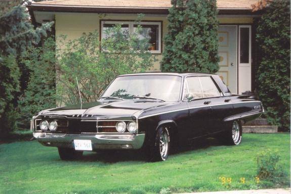

I found an old pic of the monsterco. This was in 04 right after I painted it black. Was originally brown.

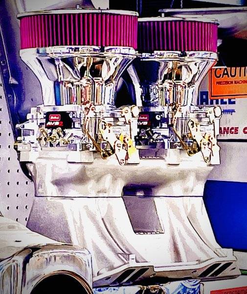

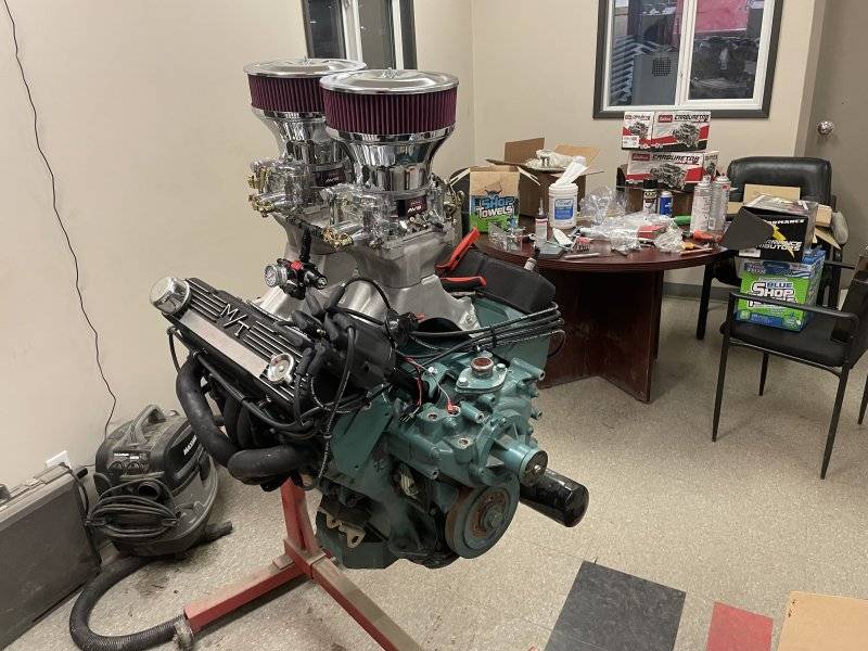

Well it’s been a busy year and a half. Work has sucked so much of my time. But I’ve done allot of parts trading/fixing on the side and tune ups but I finally have my tunnel ram and carbs and air cleaners. Just waiting for my Heim joints so I can connect the carbs then I’ll put the tunnel ram on the engine. I have a 3000 stall converter for it now and just acquired a good 727 B&m shift kit. Have almost all the stuff I need to bolt it into the car.
Things got off track the last 4 months. I won’t get into the details but the last couple weeks I was able to start working on this again.

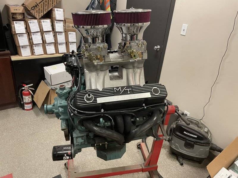

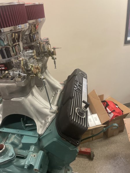

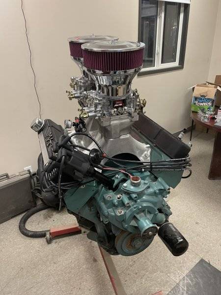

I now have the engine completely ready to bolt in. I just need to get my trans from the shed and put my shift kit in it.
I have a reasonable solid roller cam in this engine. 253/256 duration @ 0.050
0.622/0.609 lift. It’s a tight lash cam so I cold lashed it 0.010 and 0.012. Once I warm it up I’ll hot lash it.
I purchased a perf world distributor (has the same internals as a msd) and put 8.5mm perf world wires - cut to fit. I have all the nice crimping tools which helps. I have 2 500 cfm eddy avs 2 carbs on top.. I’ll have to do lots of tuning I expect as I want to drive this on the street and have it have reasonable manners. I even have electric choke I put on.

It’s all cool - I was going to drop in my x1000 but now won’t bother. I know it’s your car and all - especially coming from Pops. But “if” it were mine - I’d drop the car down some - it sits up too high all the way around and takes away from that Charger bad *** look. Ok … None of business I know. I’ll shut up now…..
