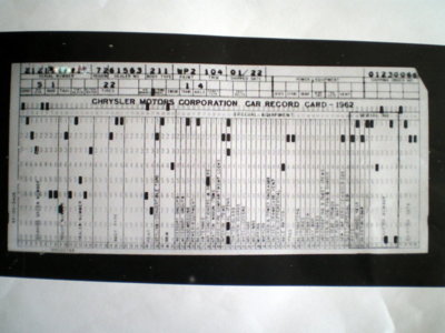

Just wondering if anyone out there would decode my build card for my car?? I really wanted to know who & where was the original dealer was?
Chrysler might be able to tell you where region 72 was or possibly still is. The region # is the part of the country where the dealership was located. 61563 was the dealers ID #. My dealership was in region 44, Syracuse, NY. My ID # was 9075. The # being so low because my father started with Chrysler most likely before ID's were even issued (1924). Here is a picture circa early 50's.

Looks like a FCA microfiche copy. Didn't receive a letter from them with the breakdown?
Region 71 is Los Angeles, so maybe 72 is close.
Ask Jon over on the early Charger website/registry if he knows what are your region and dealer. He also provides perfect copies of your buildcard, for a fee.
Your codes are right on the card.
For some, you combine the lower number with the punch hole number to get a 3 digit number. On mine, 1 is punched above 69, and 691 = ordered car.
Others decode to a letter, like in the paint code, 2 punches in the same column = a letter.
Others are just single digits based on the punch hole, ie Body Type 211 is written at the top and 2-1-1 is punched above 19-20-21.
Once you get the 3 digit codes, that aren't written on the top, google them.
It's difficult to see yours, but 361 is radio, 385 is heater. I can't read what's above 41, but 412 is listed as dual air conditioner - is that even possible in 62?
I don't have the 62-65 book, which would help, but that's not even 100% correct, and some of the early online codes are incorrect as well, but it's a good start.
http://blackhillsmopars.org/files/pdf/62to68OptCodes.pdf
72 is Portland
6 cylinder lynch rd detroit car.
