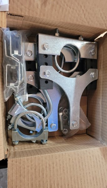

With the TTI provided hangers, bolted to the stock floor brackets. Apart from this it is bolted to the exhaust manifolds on end end, and the tip is suspended from the stock rubber block on the other end. When I first installed it, one of the pipes would touch the frame rail, and that made a lot of racket.
That should be OK. An experiment to see if you can change the vibration/noise is let one of those rubber straps off and go for a short ride.
