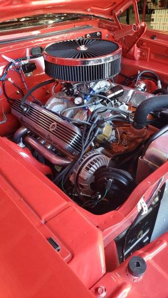

The Coronet has about 300 miles on it since the restoration. I think the oil pressure seams funny to me? It has a plumbed oil pressure gauge along
With the stock light. Engine was professional built and Dyno run before install with no issues that I know of. When I fire it up cold it seem like it take to long for the pressure to show up on the gauge and dash light?
Once it come up it runs 70+ pounds cold and 20 at idle when warm. When shifting the car the pressure drops fast then picks right back up? Is the fluctuation in the gauge normal when shifting?
The last mopars I had did not have gauges or this kind of engine. Also when running it hard(5000 RPM shift) the oil pressure drops to Zero but that maybe because I am not running a baffled oil pan or windage tray?
It has 6qt of oil in it and it looks to be a rebuilt stock pump. Think I should swap out the pump? ….Oil filter drain back? It has a Wix filter and also tried a fram… Thanks
