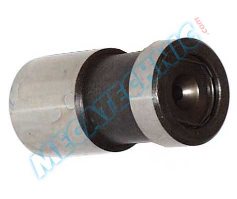

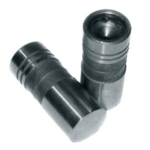

Word of caution. You CAN run zero or near zero lash with hydraulic lifters......you can even run LASH. However....and this is a BIG however, you GOTTA have the right lifters to do it. Standard hydraulic lifters have a cheap *** little wire retaining the plunger. Do NOT run those with near zero, zero or lash. They will pop the wire retainer out and the lifter will come apart. You need to run a sho nuff anti pump up lifter, OR a heavy duty hydraulic lifter. Either of those will have a flat, heavy duty snap ring retaining the plunger. They will not come out. ...and if they "claim" to be a heavy duty or anti pump lifter but have the wire retainer, DON'T BUY THEM. They are craptastic crappola crappomosomous.
Here's examples. The first lifter is a craptastic piece of dookey. I wouldn't run that in anything. The second one is what I am talking about. That's the good ones. I don't care who makes um. If they ain't got that flat snap ring, they ain't diddly doodoo. There's a LOT of lifters out there like that too. They ain't got no business in any kinda high performance engine. I wouldn't put um in a stock 2 barrel motor. JUNK.

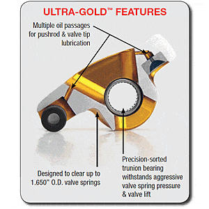

Some of the aftermarket rockers and aftermarket springs/retainers don't mix well.... I have seen the rocker be so thick around the shaft that it actually can touch the larger retainers when the rocker gets part way through its motion. I have seen some people grind out this area of the rocker to achieve clearance.... It's right where the section of the rocker that goes around the rocker shaft and transitions into the lower part of the arm as it directs towards the valve.
See the picture below as it indicates being designed to except larger valve springs.

Absolutely. This is one area where you really have to watch it. chebbies have wussie 1.25" OD valve springs. The industry sometimes forgets that there ARE companies out there that used REAL valve springs in their engines. Lots of variables to check for, sho nuff.
