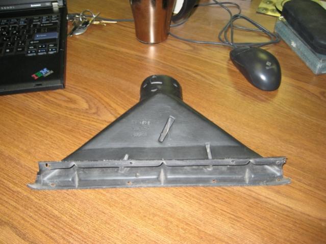

First I want to thank 66sat440 for an ingenious repair on his defroster vents. This has got me thinking about repairs as well. I suppose I never considered a repair due the issues with it not appearing correct for a concours restoration.
What I need to know is how many of you would accept a repaired defroster vent, welded or otherwise? Also how bad of condition are yours? I am about to attempt a welding repair today. I believe these ducts are made of Polyethylene, which means welding is the only reasonable repair.
Please post pictures in this thread to give me an idea how bad yours are.
66sat440, I didn't mean to steal your thread, in fact I credit you for getting my mind working.
Cheers!

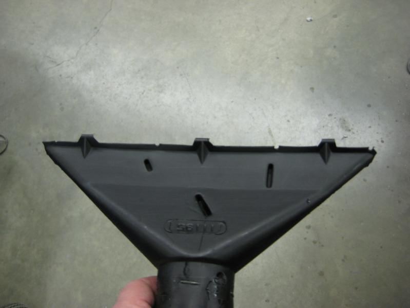

Here's the vent before welding.

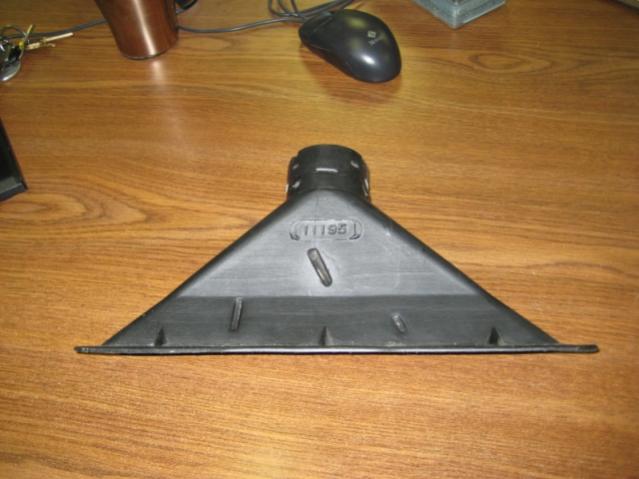

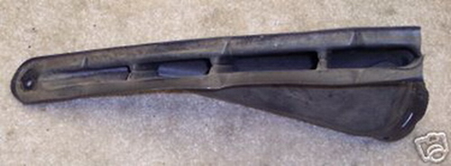

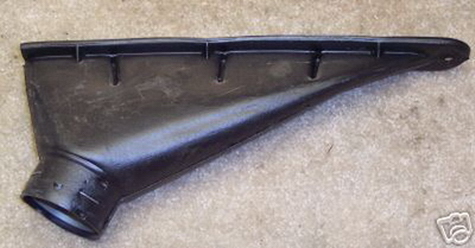

I've looked at 100's of these defroster duct vent nozzles over the past 20 years and the two area's of damage that I have usually found, are that one or both of the mounting "ears" or tabs are broken off, or the top edge of the vents are warpped from the sun. If Chrysler would have made these area's a bit thicker, these parts would have lasted for just about forever, as they are SOOO tucked into the dashboard shell, that the only area of the vents that see daylight are the top edges, which are the weakest area of the vents! :black_eye:. Some of mine look like the one pictured below and some have been badly repaired and a couple are just cracked.

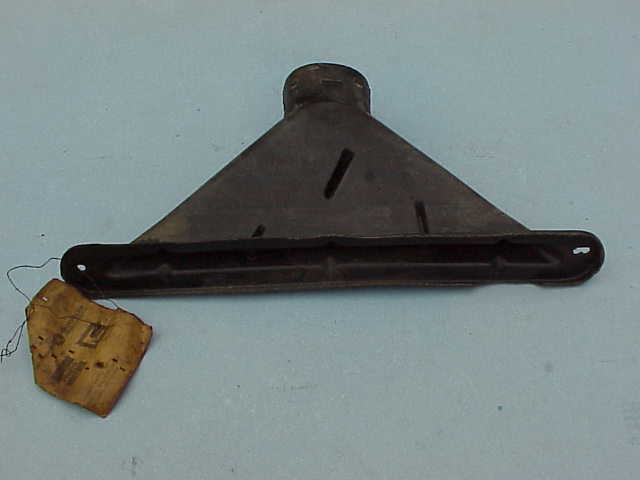

I do have the ONE nos passenger side vent shown below with the tag on it, but I'm afraid to use it as if I can EVER get these reproduced, my nos vent could be used to make the mold for the new passenger side parts.
Richard

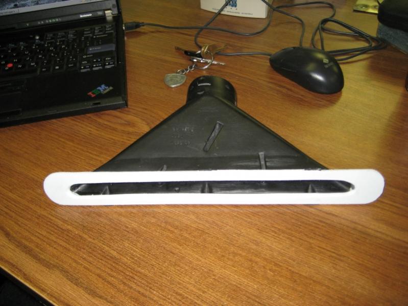

I am missing the drivers side vent as my car came to me dissassembled. The flange I am welding will be 2.5 mm in thickness. I am welding it up this afternoon, I have just fabricated the flange.

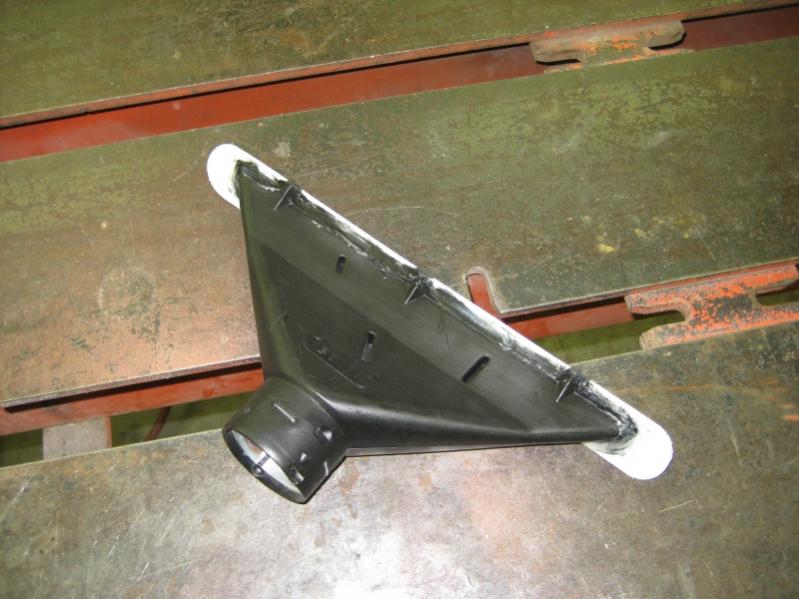

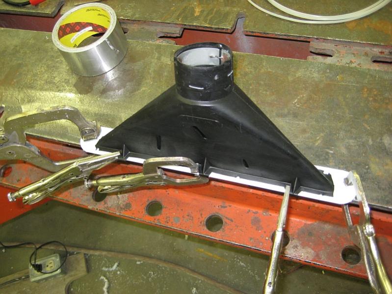

The Repair

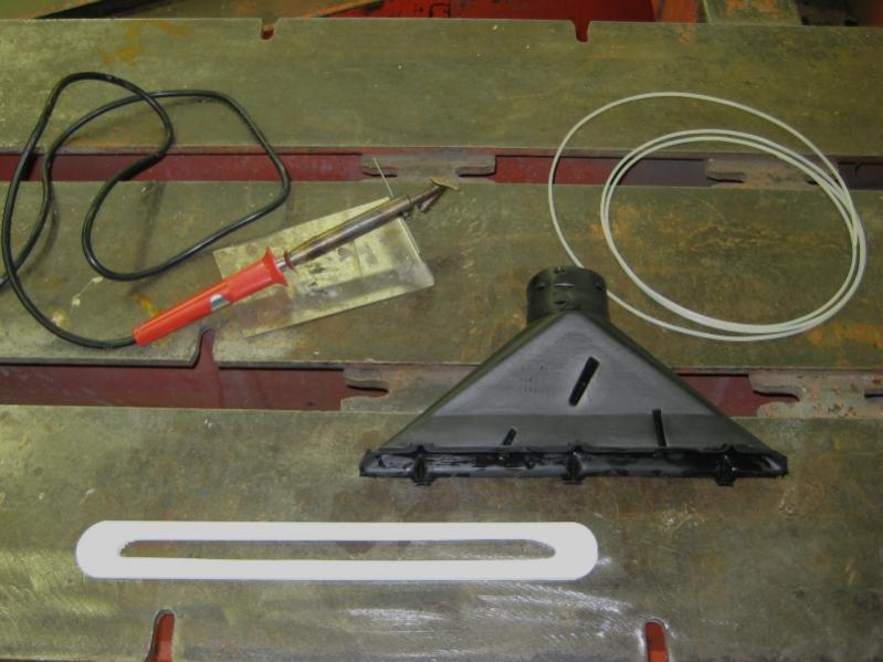

So I positively identified the plastic as Polyethylene, which absolutely requires welding as there is no known adhesive that will chemically or mechanically bond to it. So I welded.
The following pictures show an airless weld (fusion). Not a hot glue gun!
I obtained a 2.5 mm thick piece of PE and rough cut it to fit. I then notched the flange leaving some of the old material for alignment purposes. Before welding everything was cleaned thoroughly with plastic cleaner then clamped together. I used PE welding wire and fused the new mounting flange to the old vent.
Once the welding was complete, I stress tested the part well beyond its required strength...she's a keeper. While this plastic is white, I am sure I could find black PE. Paint does not adhere readily to PE, but I will use some plastic adhesion promoter and see how it works.
What we wind up with is a part that has not increased in dimension in any fashion, and has a very solid mounting flange...cheers!
Once again, thanks to 66sat440 for getting me going on this little project.
