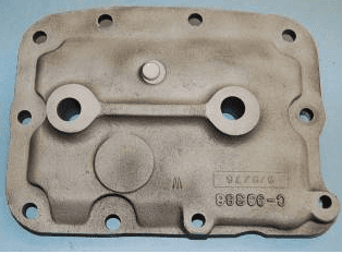

Unfortunatly no. you have to pull the side cover to be for sure. One thing you can look for is if there is a bar on the side cover. If so it is the later scissor style cover and more than likely will have the 2:44 ratio. The earlier ball and detent side cover would have the 2:65 ratio, if no one has been inside of it. 340 or 440 6-pack, I am assuming you mean a big block. The 340 6 pack cars had 23 spline. Post the VIN it may help

I will be looking at it this weekend. I think velocityss1985 is correct. Early has a smooth cover and later cover has a raised casting. I looked for photos and found these:
