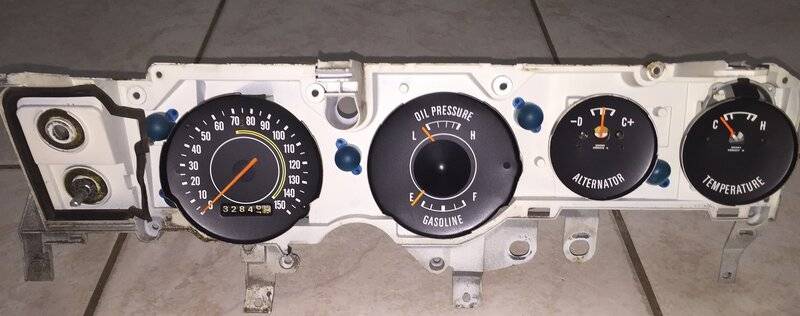

The standard dash had oil pressure/fuel in 2nd large pod. You could option either the clock or the tach. If one of those were optioned, the oil pressure/fuel moved to one of the smaller secondary pods.

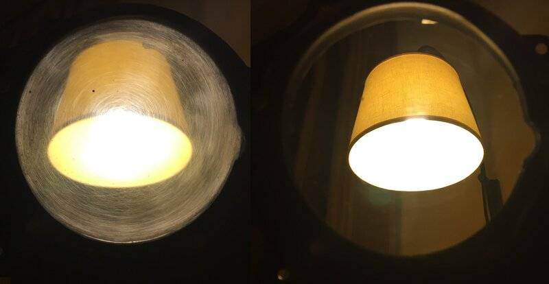

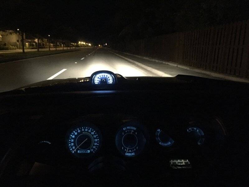

Mines a 72 RR ...not a GTX, but it has the oil/gas combo where the tach would be in standard package as mentioned above. I didnt want to modify my panel from original, but did want a tach so added it to the hood instead. I also have a before after picture of my instrument lenses to show how easily they can be polished up almost like new! Only took me about 5 minutes per lens.

you can even use toothpaste for polish plastic!!! I got a cluster what sold quite ago with deep marks and they dissapeared down toothpaste used as a polish paste.
If I remember it was the polish used for headlights and a small buffing wheel on a drill.
1st coat baking soda.
2nd coat Plastx or Mothers.
3rd coat banana (peeled).
4th coat polish with armor all.
Toothpaste and or this works as well
