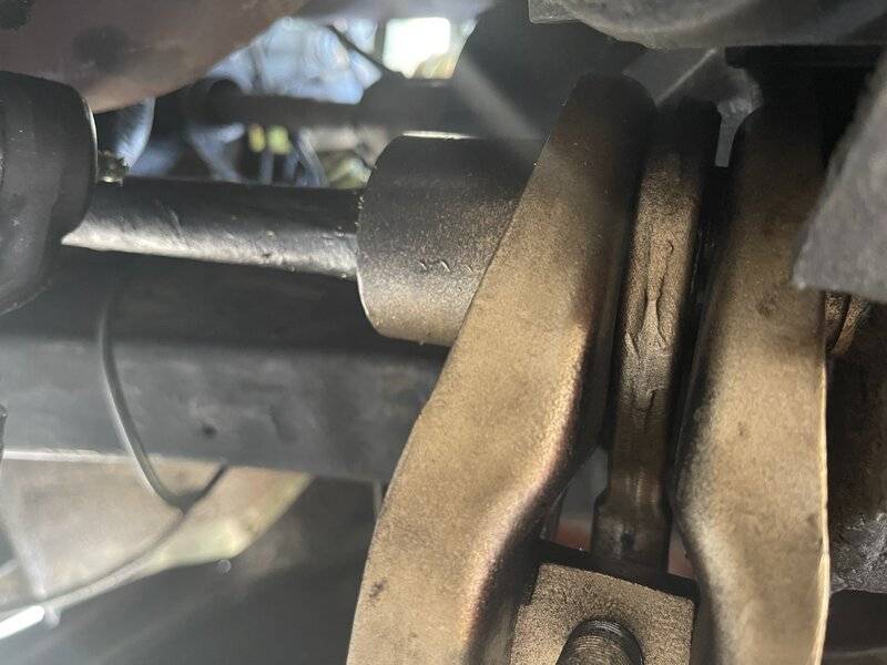

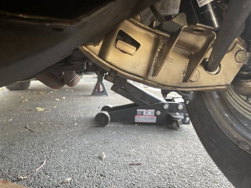

Replaced my lower control armb bushings because one was bad and running metal to metal so decided to replace both but when I adjust the height of the car one adjustment bolt is higher that the other ? see pics
is this normal or did I do something wrong ?
I made sure the pivot bolts and torsion bars all went in and locked in place as far as ant parts joined together
is there something else I should look for ? Should I way for it to sit down ? Or drive it then check again ?
I have not road tested the car and also put new shocks in
I would get it on the ground and measure. Drive the car and see what it does. Both identical is not a requirement but it should be close on each side.

Just a guess, but did you clock your torsion bars correctly or just put them where they slid in easily. The only other thing that I can think of is a very weak torsion bar on one side.
I don’t follow?

Did you pull the torsion bars out? If so, you need to remove the bumpers to put them back in, that would be considered "0" as far as installing torsion bars
I did remove them I just slid them out of the control arm and then slid them back in. They did spin a few times to for but I didn’t remove them completely
Someone else can chime in, but I believe you can't do it that way. I did that one time, and had to remove it, and remove the bumper and reinstall

It is highly UNlilkely that the hex is clocked wrong if the adjuster screw is only off by a few turns. When I have installed a bar out of proper index, either the adjuster screw hangs below the control arm by large amount or the screw is cranked in until it is almost bottomed out.
Check your torsion bar cross member sockets. Make sure one of them hasn't started to let go and has spun a tad.

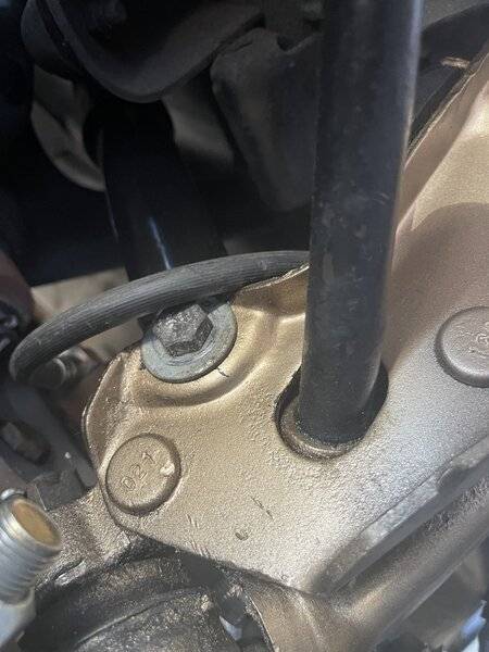

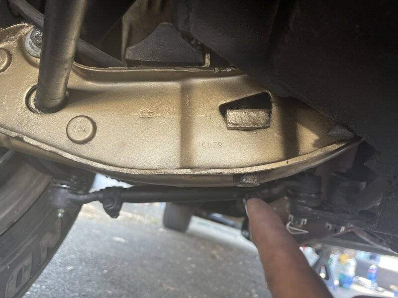

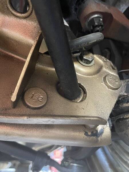

how would I know if it’s clocked wrong ? is it possible that maybe since I rotated it to install it that maybe put the bar in a different side with less wear so that’s why it’s higher? I took these to see if they help
Are both adjusting bolts the exact same length? There are some out there that are longer. I would also ditch those washers on the shock bolts, use a smaller one or no washer so when you torque the bolt it exerts maximum pressure right on the shock sleeve....many mystery front end chunks caused by that, and the fact so many shocks no longer have serrated ends on the sleeves.
You have to drop the suspension as far as it will go, with the bumper stops removed. Your bars are not clocked simultaneously.
It's pretty hard to get a bar off by 60* guys, you'd have to install one with the LCA adjuster lever as far up as it could go to get them that far off.
