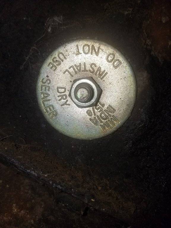

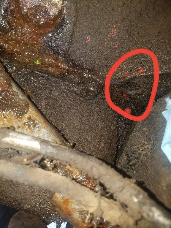

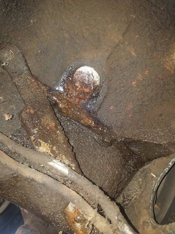

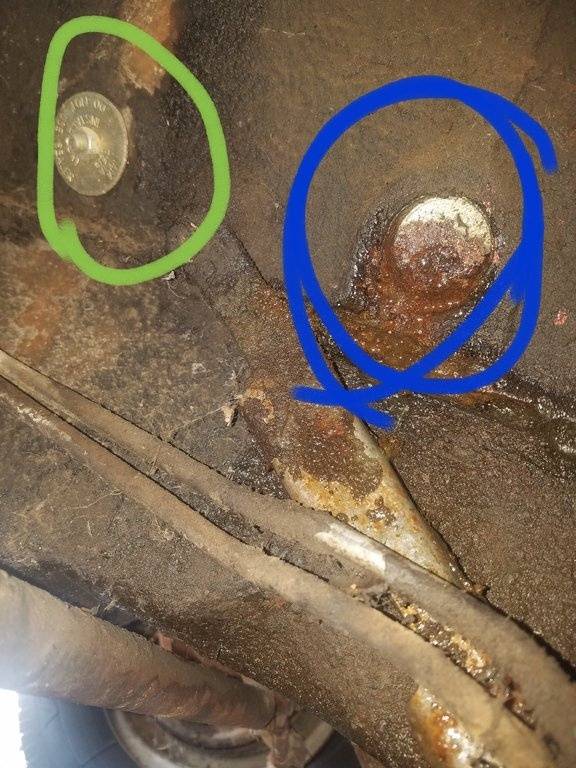

Hey guys I remember two weeks ago I said i had a leak of coolant from under the engine? well I took off the starter and I found where the leak is coming from I just don't know if it's the freeze plug or something else. I also want to know if it's something that's just a patch up and I'm good to go or if it's way way worse. In the blue circle is where I believe the leak to be coming from. In green is a cap of some sort that i was hoping you guys might know what it is. and in the red one is an empty hole that hid behind the starter is something supposed to bolt on there?
Whack the lip with a hammer & punch until it turns sideways in the hole. After you dry off from taking a bath in engine coolant, you can then pull the plug out and replace it with a new one.
In the "Blue" circle it looks like a Freeze Plug
And in the green circle is another freeze plug fail that was repaired with an expanding rubber type fix.
BTW the reason it says to not use a sealer is to help it to grip and not pop out from the coolant pressure but it will still pop when freezing happens.
So that is two freeze plug fails.--There are more to come.
so I'm gonna have to drain the coolant first unless I wanna take a coolant shower

I don't see the point in that. What you need to do is step by step.
The expanding plug fix is user-friendly. Installing a plug like the factory ones requires a good shot of being able to drive in the plug straight and true. This is tough or impractical sometimes with the engine in place.
Knock out your leaking plug and clean the hole as best you can. If you don't have the room to properly drive in a new one use an expanding one to get you back on the road.
However--since you have now two leakers another may not be far off. They all are the same age and have had the same life.

I only have one leaker that's the only one that leaks the self expanding one is completely dry and on the other side there isn't any leaks.

My two cents is to open and clean your leaking freeze plug hole. if you can drive in a stock plug this is a plus.
If not --you can see what success can be had with an expanding plug. (by the other one that is working) --No leak--car drives--

You really need to replace all your core plugs "freeze plugs" if you will. You have one leaker, one quickie expansion plug already in play.
Drain your coolant starting at radiator, remove cap, thermostat housing also.
Let it drain, remove block drain plugs, let it drain completely.
Like RC mentioned, drive one end of the plug into the Block with a round chisel (brass) if you have one. Before you start, notice how deep the originals are set in the block. Be careful not to score the mating surface if possible. Pair of pliers can pull out remains. On a big block the front 2 will be behind the motor mounts, fun. Jack engine safely,watch fan/ radiator clearance, remove mounts, hammer away.
Flush the block completely through the water pump housing where T stat mounts, until clear, backflush too.
After 3 days of flushing to get all the crap out, ok maybe a little exaggeration. Clean the block surface best you can, I use a dremel drum sander- lightly. Install DEEP BRASS plugs.1 5/8 I believe, coat them with your preferred sealer, I use permatex aviation - just my choice. There is a special tool to drive them in to depth, I just use a socket the same inside diameter as the plug, and get them straight. I highly recommend BRASS as they do not RUST, and are better at sealing irregularities. Deep ones can be mounted flush with the block. I get mine at NAPA in bulk, but you'll need 6. Order online also if so desired.
Since you've flushed everything else, pull the heater hoses off and do the heater core also, same thing, backflush til clear.
Then put it all back together........
Or start on the 1" ones in the heads, you're a pro by now.

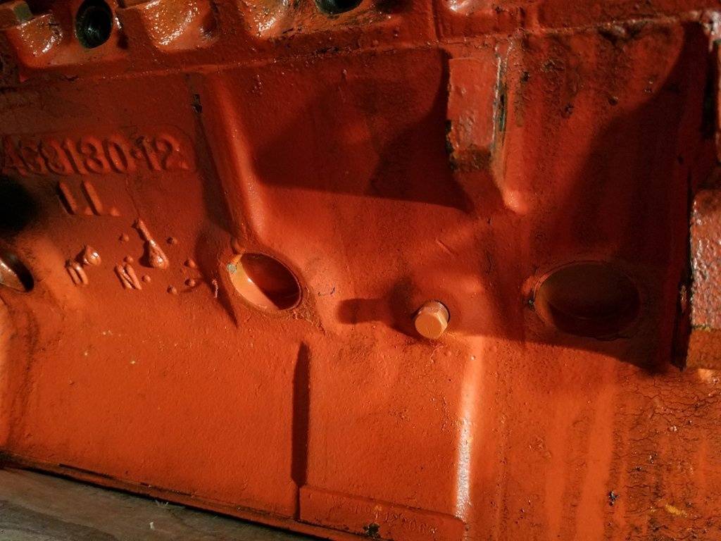

Attached is passenger side 383 showing plugs and block drain. Driver side same
I agree on deep brass plugs, abut if you aren't planning on pulling the engine, you can probably get a few hundred or even thousands of miles on the rubbers.
