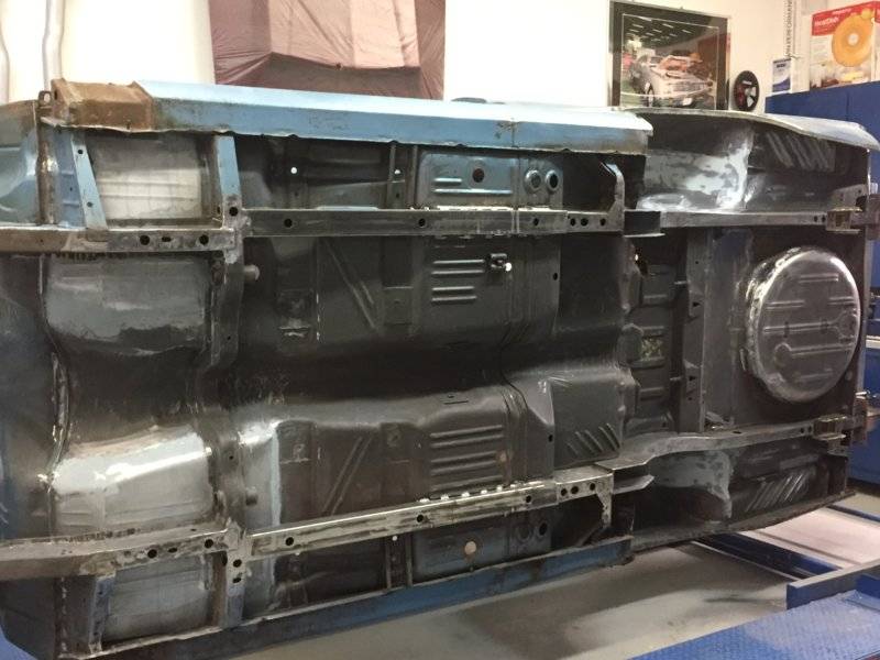

Bottom is ready for final touch ups prior to epoxy.

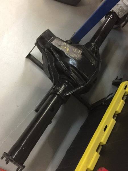

The Dana is narrowed. Ready to order axles, spool, etc. Borrowed a shaft and blocks, did the job in house.

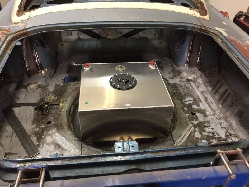

15 gallon fuel cell base is done. I don’t like the way the spare tire tub hangs down on these Darts so I raised it up 3”. Tucked up in between the frame rails now.
