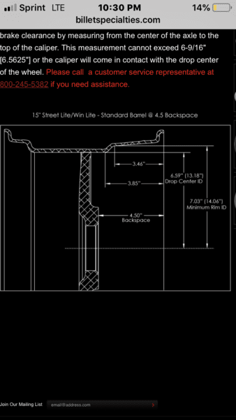

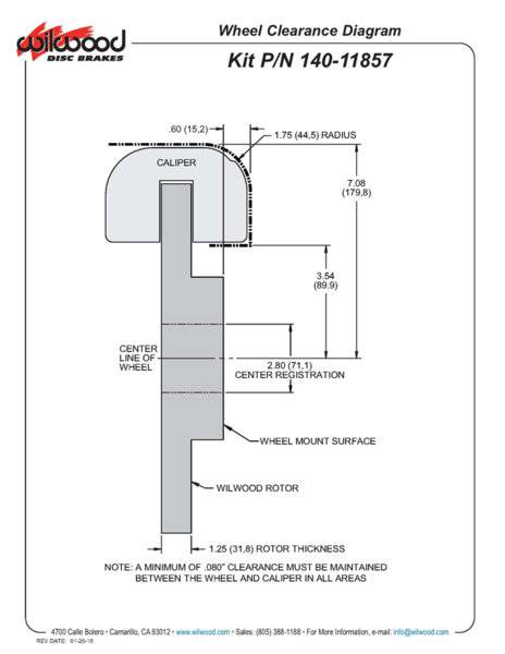

You need to measure the caliper clearance on your wheels he can’t do that for you, and get the measurements for his kit and see if it will work with your setup.
His kit doesn't have that measurement. It only specifies the rotor size as 10.95." The inner diameter of my wheel is just shy of 13.5 inches. I took one off and measured myself. I would think he would have told me the clearance measurement if he knew it. He probably has never been asked to measure it as whole unit like that.
This is what you need from cass, I have a hard time believing he doesn’t know the measurements.
That I have no idea, guessing if it actually is a thing it has to do with back spacing.
These are the measurements you need from your wheels to compare, take not of any steps or drops in the drum. Measure your lowest points
