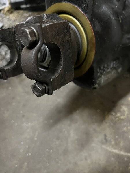

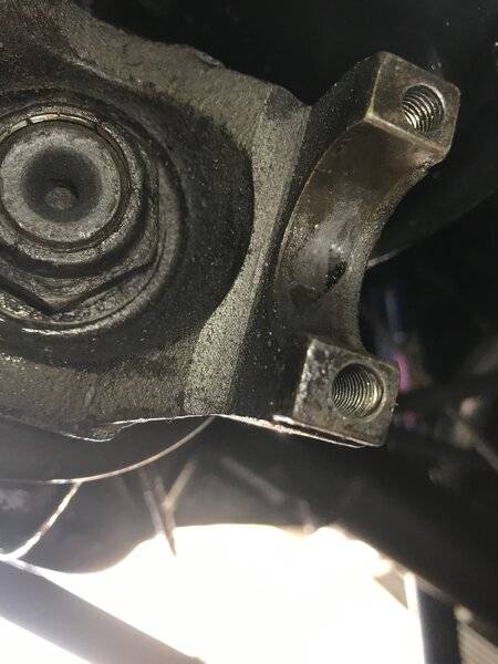

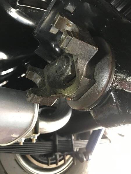

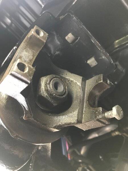

1st photo - Yoke in Dana. 2nd photo - threads in yoke - definitely not drilled out. 3rd photo - 1/4” bolt that was used with straps slid into threaded hole to past start of unthreaded shank. Bolts about 1-1/2” long.
Any idea what’s going on with it?
No u-bolts, used caps with bolts. The pads are typical of those using caps. Don’t think it’s drilled out or they would logically have drilled and then tapped for a bolt available such as a 5/16”. It’s well tapped, thread cuts are deep, but not sure what for.
If it’s 7mm (unlikely) it’s pretty much as rare as finding a 9/32” bolt.

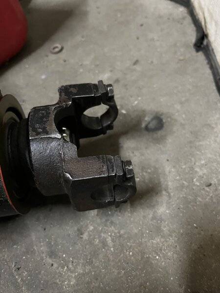

That yoke looks exactly like the one in the 489 sure grip I have. I don’t have a bolt sizing tool but I do have a tap and die set I can check the threads with if need be. View attachment 1280322View attachment 1280323
Some one modified it. The straps are already inherently weak, and enlarging the hole makes them weaker. The larger 7/16 head makes it hard to get a wrench fully seated.
