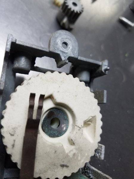

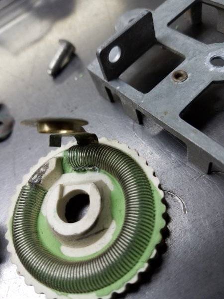

On the dimmer switch the coil has come unglued, I was wondering what would work to reglue this.
Looks like old pasty white stuff. I cleaned it up so that is why whole coil is dangling like wet noodle.
I did a search and couldn't find anything yet.

Thanks for replying, I am working on a customers 69 charger. And am I testing ways to repair on a couple other broken ones first .
I do realize I can buy a new one but being stubborn and wanting to fix what I have, they are very well built and lasted this long.
Seems these roller knob style need more repair than others I see.

I would think you could use whatever you want to glue it back down as long as the ends are making good contact. Maybe a thin bead of weather strip glue, or something thick like that for the spring to squeeze into ?

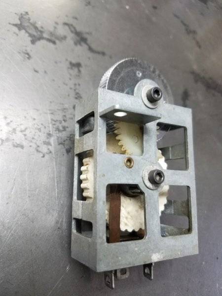

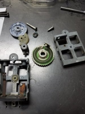

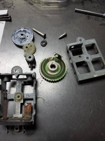

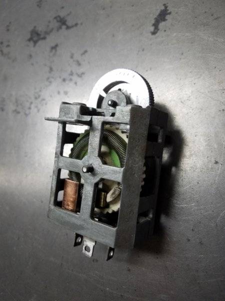

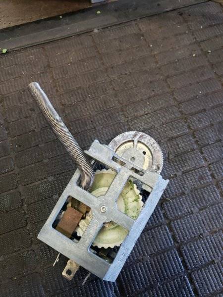

That is the one switch that doesn't come apart easily. I drill out the rivets, clean all the contact points, apply dielectric grease, tap the 2 holes, and use 6-32 socket head cap screws to put back together. You should be able to epoxy the spring back down.

Best would be an electronic epoxy/potting compound like Max MCR...not cheap but using any type of glue, I would doubt the strength in those conditions over time. If that piece were to spring loose again while in operation, that could be bad..do it right, or just replace it..
One detail must be considered! The REAL deal there is attach the end of spring. The glue is the easy part, just plain an simple epoxy will make the job. No special glue needed. BUT the end is loosen, so mostly sure got broken from the rivet inserted on ceramic?
