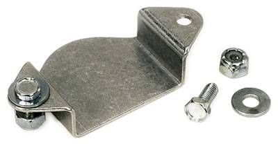

Thanks Bill. Yes, it certainly appears I lost a quart between changes. Probably 300-500 miles (absolute max). My level on dipstick was never low. I'm definitely not getting blue smoke and engine runs fine. I have Moroso valve covers and installed these baffles to prevent loss through PCV. The fact that my dipstick was always reading full (or close to it) is what had me so alarmed that I only pulled 4 quarts.
