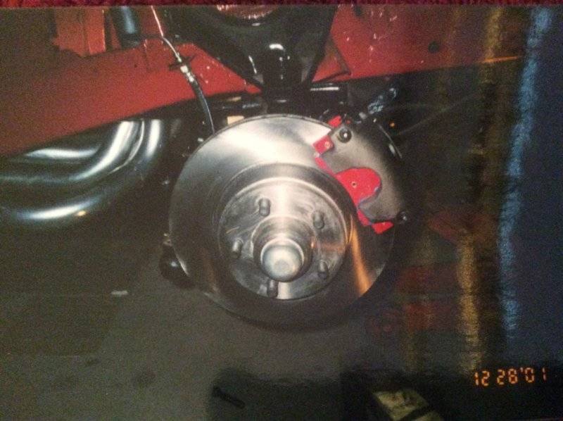

Did a disc conversion on my 65 Dodge following a Mopar Action article "Disc O Tech. That conversion is to expensive now. Dr diff is the go to guy as others have said.

Did a disc conversion on my 65 Dodge following a Mopar Action article "Disc O Tech. That conversion is to expensive now. Dr diff is the go to guy as others have said. View attachment 822476
Is that a 66 satellite Hemi convertible you have there cuz if it is, I get it, thanks for the response I was just going to have you show pictures of your setup
