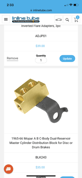

I’m doing the same on my ‘66 Belvedere II with a non power dual master cylinder. Curious; did you add proportioning valve to your setup. I’m assuming that’s what I’m needing to do with the block shown in the pic below. I’m scrounging the forums and this seems as good as thread as any to ask the question. Thanks.

That's a basic distribution block.
You want a proportioning valve that isolates front and rear.

Thanks for the responses. For what it’s worth, I’ve scrubbed these forums until cross-eyed trying to figure this out the prop valve/distribution block requirements for my application. I’ve got the front rotors, dual (non boosted MC) and line kit installed. The only thing I’m not grasping is; do I need a distribution block then prop valve after (2 components) or do I need a combo valve? Appreciate the patience and advice.
You need to install the proportioning valve in place of the distribution block. The Proportioning valve reduces the pressure to the rear brakes so they don't lock up before the front discs do. Pretty simple once you get the right combination.
This makes sense. In my head I’ve been picturing a proportioning valve as adjustable (with the knob) that is used in conjunction with a distribution block.
Sounds as though I’ve been making it more complicated than it needs to be. Thanks again
All you need is an adjustable proportioning valve in the rear line, and a tee in the front system( rear reservoir) to split the master cyl. line into two, one for each wheel.
Even simpler. This is what I will be doing. Thanks for the guidance.
