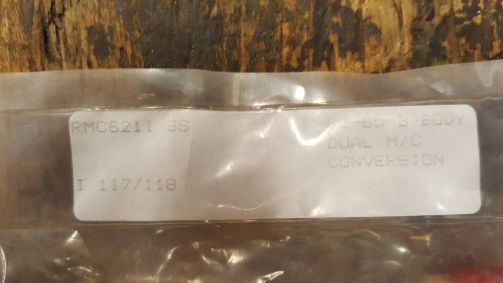

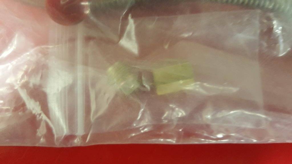

This is all you need to convert to a dual mastercylinder. Don't know what you might need for the front disk setup. Depends on what you end up installing. These are by Finelines and you use the original T block.
