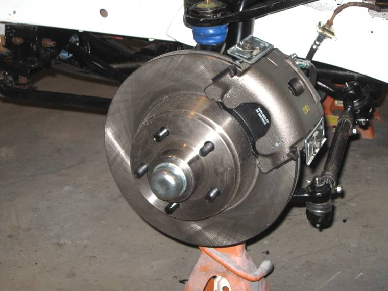

            I got the spindles and caliper assemblies from a 75 Plymouth Valiant. I also got the Proportioning valve and lines from the master cylinder. I used the brake hoses from the same Valiant (but new). The hard lines are the easiest thing to bend up. For a master cylinder, I like manual brakes, so I used a manual disk brake master cylinder for a 76 Volare. It is cast iron and looks right at home in the 65 engine compartment. You can also use the later (79?) master cylinder, but it is aluminum with a plastic reservoir. It doesn't look quite right in the 65 engine compartment. Basically, everything from the Valiant just bolts on. Simplest upgrade (on my 65 Belvedere) I have ever done.

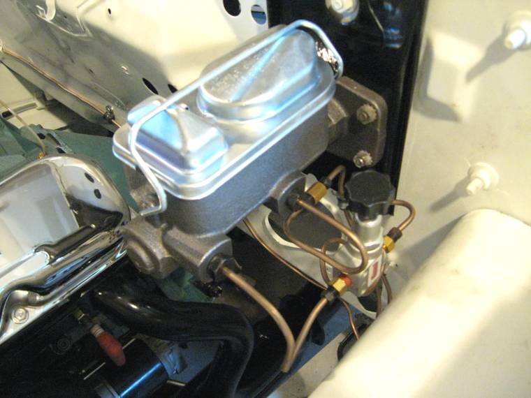

                You will need to make up the hard lines. There are a couple ways to go. You can source a stock style proportioning valve, or you can purchase an aftermarket adjustable unit. I used a Summit adjustable unit and mounted it beside the master cylinder just to make it easy to reach. Cost is under $50. The stock style will cost more. Your choice. Its been my experience that they both work pretty well. The adjustable unit goes in the rear brake line BTW.

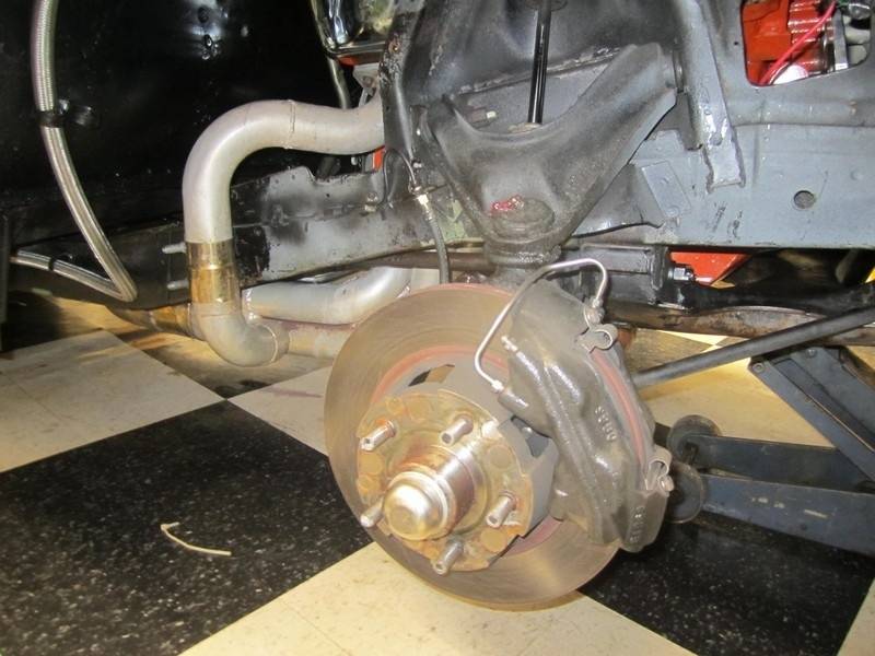

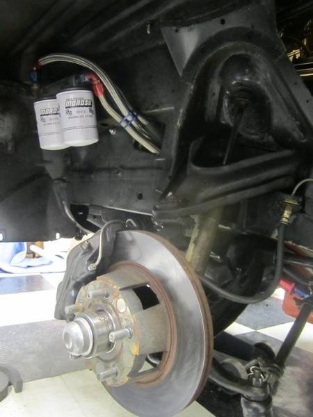

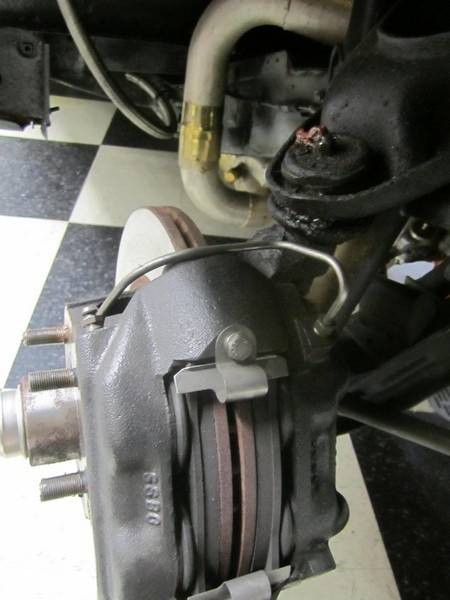

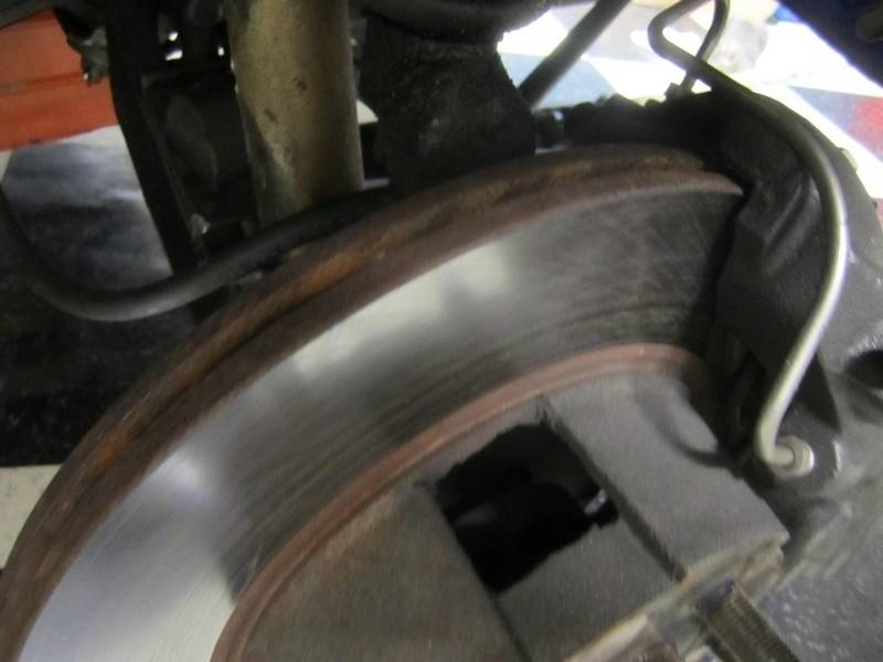

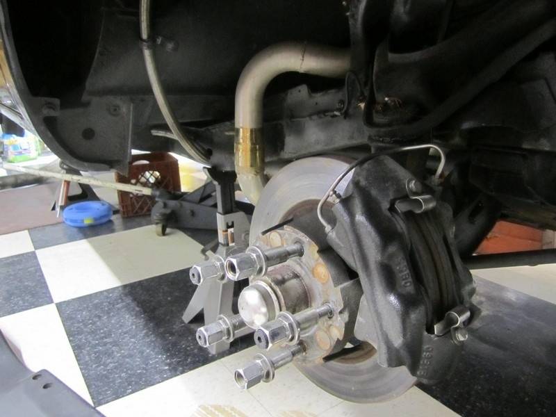

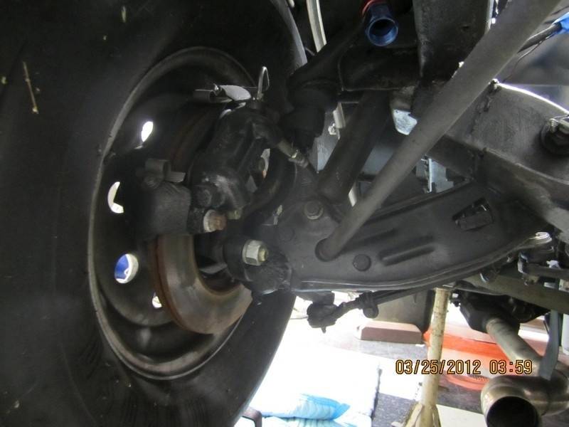

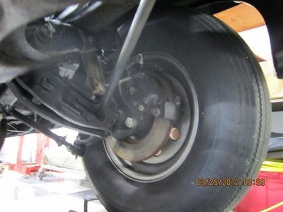

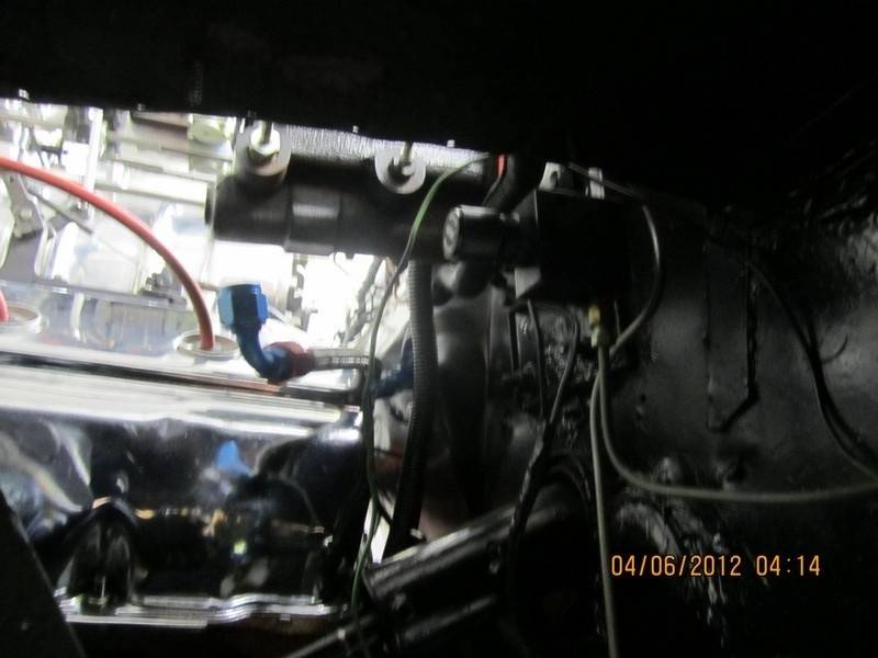

                    SSBC kit was complete with everything right down to the cotter pins.4 piston calipers stops my heap from 145 MPH.
                    3.22.14 004.jpg 3.25.12 (4).jpg 3.25.12 (5).jpg 4.6.12 (10).jpg 6.16.13 006.jpg 6.16.13 007.jpg 6.16.13 008.jpg 6.16.13 009.jpg

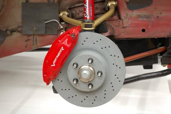

                      I used Baer rotors and calipers from a Porsche twin turbo. I used to have Viper brakes on my '65 but decided to upgrade to the Porsche stuff. You can make most anything fit on these cars. DSC_1146 (Large).JPG

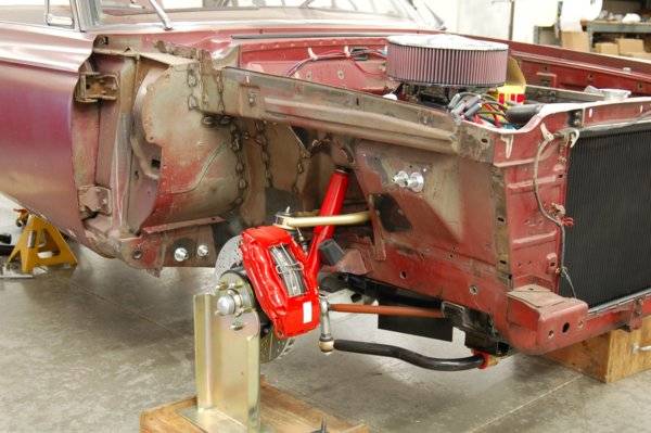

                        Here is a Viper caliper with a Mercedes Benz rotor on my '65. The MB rotor is 13 x 1.250 and fairly inexpensive from the dealer. I used this setup for a while and it worked great but was a little heavy. Felt good at 120+ mph though. Slowed the car down like it was stuck in mud. 7-21 (Large).jpg
