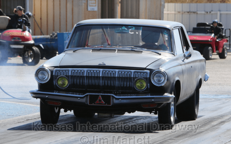

I did the Wilwood Pro Street kit (vented rotors) that bolts to the drum spindles. Very happy with it. Not sure it it moves the wheel in or out as I never ran the car with drums. They have lots of street miles and bring the car down from 133 mph on the track just fine.
Thanks very much for posting the photo, the wheels on your ‘63 look like they should. I don’t get these kits that when installed stick the wheels out, some put the tire/wheel even with the fender, and It looks like hell to me. I’m sure every marquee has suffered from this early on, until someone or company steps up! You ‘63 Looks great! Thanks
Thanks! It's far from finished but I'm having fun with it.
We race some small, short shutdown tracks and the car weighed 3,720 lbs. this weekend (with some ballast) so it takes a lot to whoah it up!

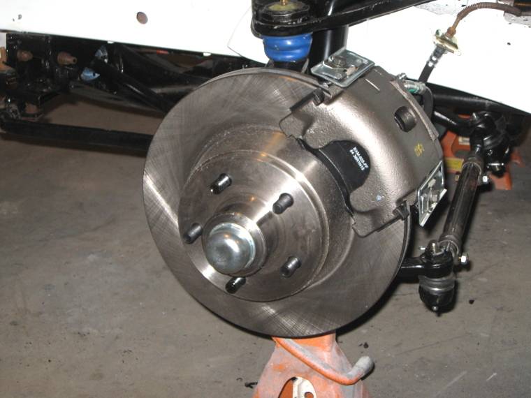

I used mid 70's "A" body knuckles and manual disks on my '64 Polara including the master cylinder. Everything is a bolt on and saved me $$$ over aftermarket kits. Works perfectly.

Call Dr Diff and only spend about $450 for factory engineered front disc brakes. You can fit 14” steel wheels if so desired. They work great on my 67 Belvedere.

I've seen the wider tracking on the A body conversions (1 1/2'') because Chrysler,in 1973 used parts from the B body parts bin to make up the needs for the A body. I never noticed this on the B/C/E cars.
This Valiant had the 73-up Power Disc set up. Running 14x5'' front rims and 15x7'' rears with a 4 1/4''back space made the tracking equal.The car also had 2'' drop spindles. Just a thought.

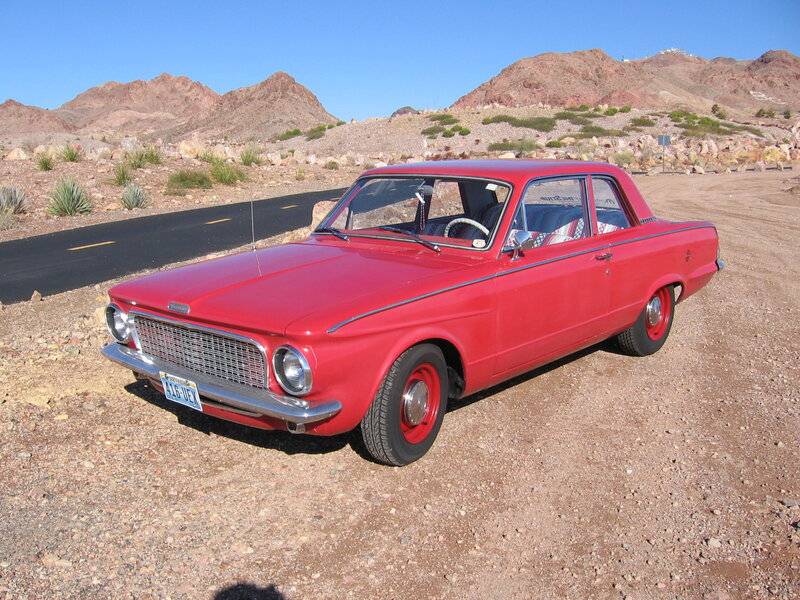

@wagonwedge330 i was going to reply to your concerns with the extra track width but @Darter6 beat me to it. It was a concern of mine too because I did the 73+ a-body conversion on my 66 Barracuda and it did push the wheels out. On my 67 Belvedere it’s not a concern. I test fit some 8” wheels up front with 4” of backspace with plenty of clearance.
Here is an article by Street Muscle Magazine that goes into detail on the mid 70's "A" body disk conversion for early "B" bodies. It should help. https://www.streetmusclemag.com/tec...ng-front-drum-brakes-with-factory-disc-parts/
Also below is a pic of my '64 with that conversion using stock Mopar 15" wheels so you can see the track width.. which to me anyway doesn't seem to be any wider than the stock drum setup.
