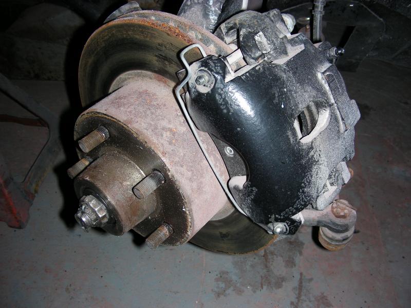

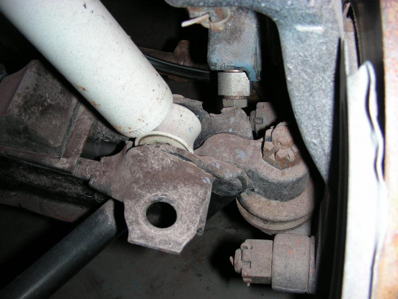

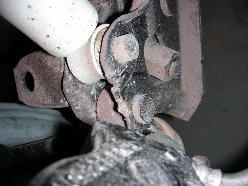

When I bought this car someone had already converted to disc brakes and I'm having trouble getting it the clear "EVERYTHING". Please if you have pics "lets see them". Here's the problem, if mounted forward they hit the factory sway bar mounts and if mounted on the back as they are now the driver side brake hose bolt hits the lower control arm. For some reason the passenger side caliper doesn't seam to have as big of a mounting pad for the hose and clears fine but not the driver side. Here's a pic of the problem and the setup "sorry, covered in dust". DSCN8770.jpgDSCN8769.jpgDSCN8768.jpg

Already tried swapping them "they hit the sway bar mounts then". Might try swapping calipers, wonder if the bleeder threads are a common thread? if so I may just re-drill them.
The calipers go on the front! Cut off the sway bar mounts,you re not using it anyway. You also have the wrong brake hoses. You need the hoses that screw into the caliper. Do this before you die please.

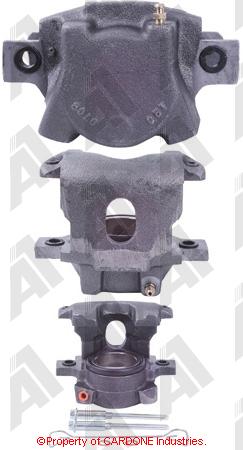

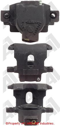

After searching Cardones sight I found the problem "I think", here's a pic of what I have (73-77 Charger).184064-01.jpg Now here's a pic of one for a 72 Charger184065-01 (2).jpg This should fix it, the big chunk hanging down on the 73-77 is were the problem is. Going to get it ordered
