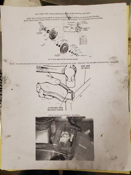

Hello all ;bought the Dr Diff stage one kit upgrading to disc in front also bought new master and booster ;no directions with kit found picture on line shows were caliper mounts ;car is a drum brake 70 Roadrunner thanks

Here's what came with mine.
I found the front conversion staright forward. Races in the rotors are chinesium so I changed them for the tokens that came with the kit. I had trouble remembering how the inner seal were to be orientated. The instructions don't mention this part.
The rear disc conversion I just did had even less detail and the predetermined length of the parking brake cables were not right. The sheath was too long and the cable stickout too short for the intermediate cable.
