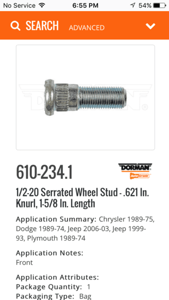

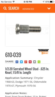

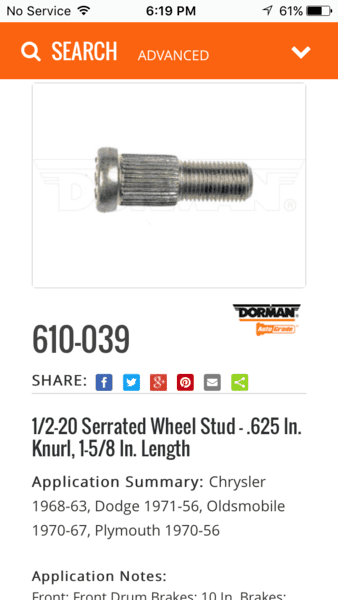

I looked up 1977 Cordoba wheel studs on Dorman and 1967 Coronet drum studs, the only difference is .004 knurl diameter. Would it be safe to press out my old ones, they're in good shape, and reuse them?

Give it a try, do just one and compare the length and knurl size. If it works, you just saved a bit of cash. After all you're not going back to drums.

You need to see what is on the rotor? The Knurl Dia can be different, the length of shoulder needed, etc... Frankly with non OEM rotors to start, your not going to get any points for LH studs. You may also find that you distort the Chinese rotor removing studs. Matters if they were swedged or not. Go look at my post on 70-72 Rotor I just posted. Drum studs and rotor studs are different, and I am believe you see a difference between one piece and two piece rotor studs too.
