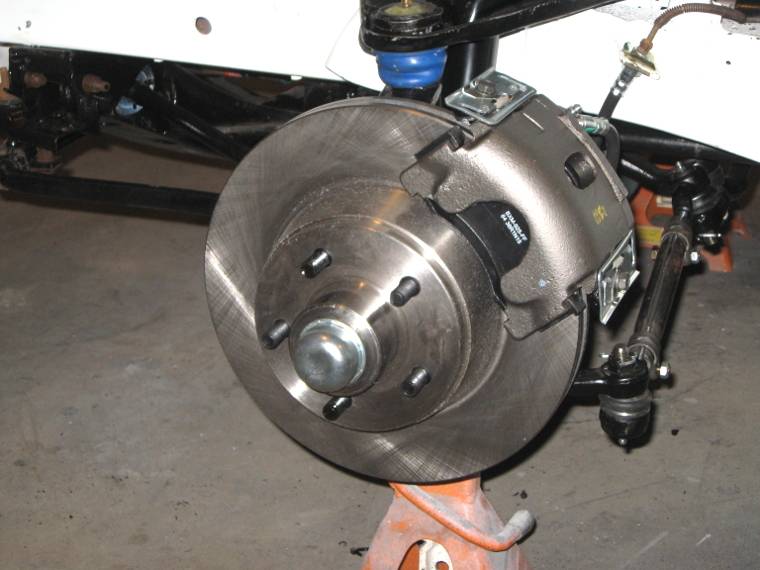

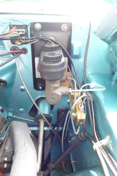

My 64 Belvedere wagon was originally a power drum brake car. I converted it to manual disc brakes. I installed a set of 73-74 E-body disc brakes. The MC is for a F-body manual disc car. A homemade 4 bolt to 2 bolt MC mounting plate. The prop. valve and bracket is from Power Master Brakes.
So the spindle from the b body will take e model rotors. Which bearings to use from b or e or they both the same. Your set up looks great i need just what you got on my car can i come over and take it lol

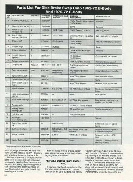

I used mid 70's "A" body front disks on my '64 Polara. With some judicial shopping on e-bay (spindles and caliper brackets) and RockAuto.com (everything else) I was able to complete the installation for well under half what some vendors charge for their kits.
I used the spindles and caliper adapters from a '75 Dart and the calipers from a '76 Dart. The rotors are from a '77 Dodge Monico and are 11.75" diameter. They're single piece and have reinforcing ribs with make them stronger than the stock Dart units.
The 11.75" rotors require the use of 15" wheels. If you want to keep the stock 14" wheels you need to use the smaller diameter 10.87" rotors and the matching caliper adapters. All other parts would be the same.

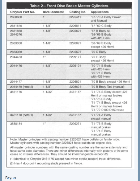

I also used the stock Dart manual disk master cylinder and a proportioning valve from Summit Racing.
