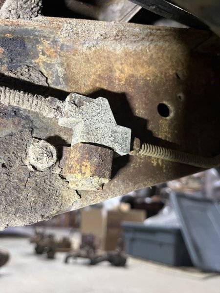

This is what I pulled off the car and it has been on there for a while.
It is a safety valve. Most call it proportioning. Me included. The valve you have is used in the drum/disc configuration. On the drum/disc another smaller vale was added and it is the actual proportioning valve.
Thanks. Do you know where the smaller valve would be added? There is another smaller “block” just down on the frame rail that the front line ties to then the rear line runs off of it. Is that what you are referring to?
Sounds like thats the valve. So you have most all the right parts.

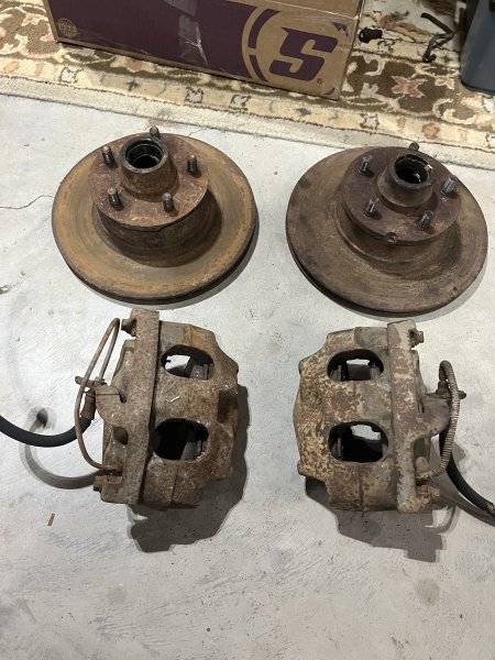

Both of those same proportioning / hood off valves are on my OEM 70 front disc car & your rotors look like 70 rotors. Was it a late 69 build?
