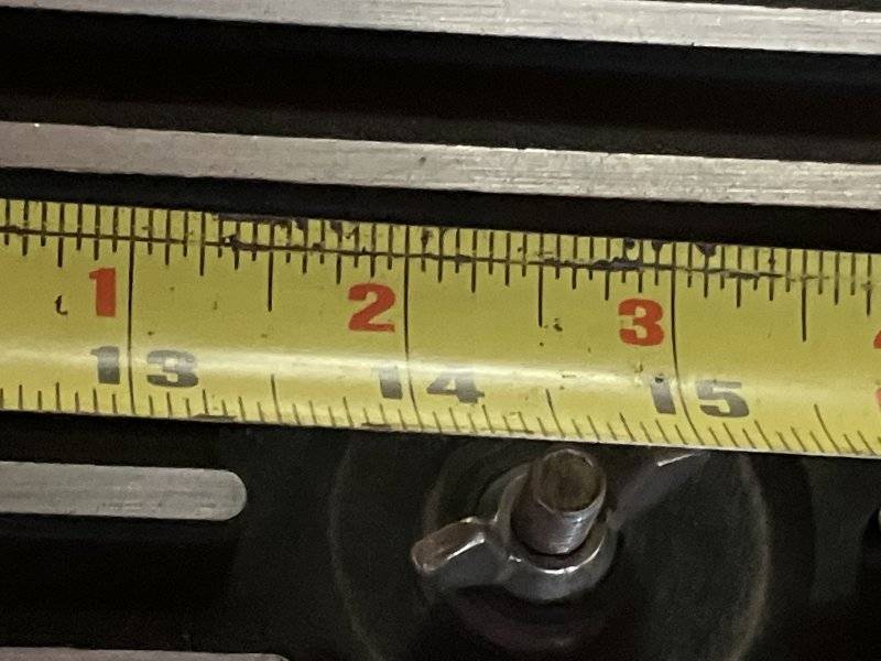

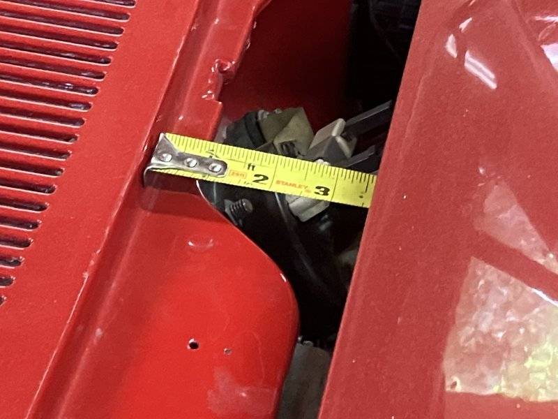

Here you go. This with a 440/495 single 4 barrel Demon 850 on an Edelbrock RPM intake.
Good luck.
Note it's not on the centerline of the car as well.
