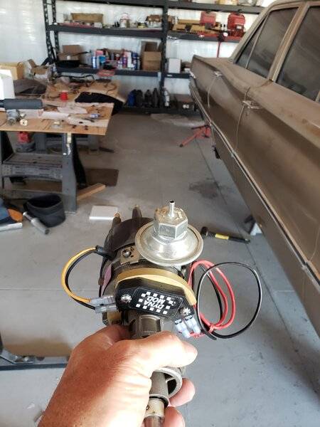

      If you want it with external module, I'm happy with the Rev-N-Nator box. Being my car is 74, the stock look on these makes a GREAT piece for me. and is being triggered by a fully adjustable MP ( Mallory ) distributor.

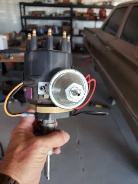

                Here's how the distributor looks w the HEI conversion. With a 50,000 volt coil and replacing the resistor in the ballast w a 10 gauge wire, it looks very stock and can allow a .050-.055 gap spark plug. 20200504_094104.jpg 20200504_094113.jpg

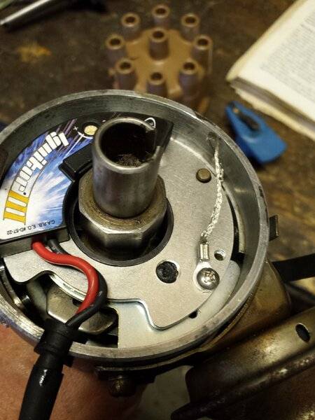

                      I'm a fan of retrofitting the stock points type distributor with a Pertronix II or III ignition. Wiring is a snap.
