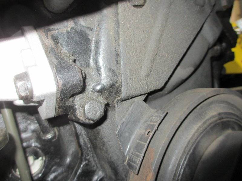

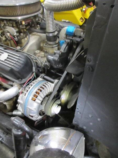

I just snapped these 2 pics of a cast iron pump and the bolt on metal timing tab. If you cannot find one it should be easy enough to fabricate one. First picture shows the cast pump and tab. 2nd shows the tab with the 2 bolts that hold the tab to the housing. Check to see if your pump housing has these 2 tapped holes as shown at the very top of the 2nd picture. You can also make out the before, TDC and after marks on the tab. Hope this helps
