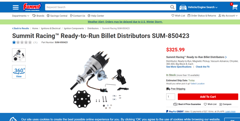

Summit offers a ready to run pro-billet.
Note the Male HEI terminals though...

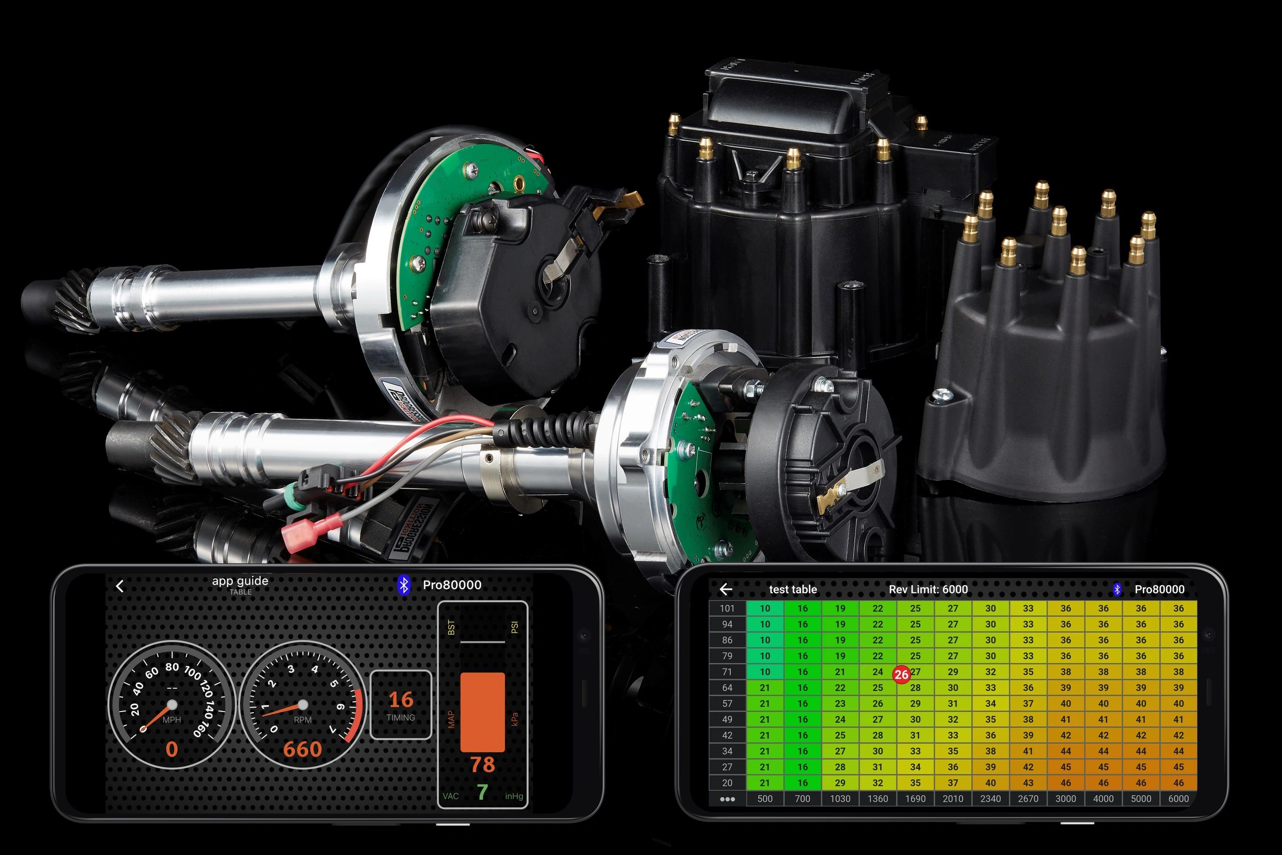

I have seen a few folks that are running these:
and they have all had good things to say. Especially nice if you run a dual function car as you can run vaccuum advance for the street and keep your car happy but also be able to tweak things at the track as needed with next to no effort.
