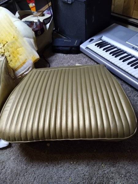

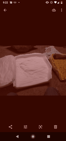

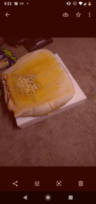

Contacted seller on eBay that was selling for the lowest price on thurs, still haven't heard back, cause I don't want to wait 4-6 weeks. The negative reviews are telling me I won't hear anytime soon. Decided the foam looked simple, so here we go...
1. Bought a block off Amazon, 44lb strength, for auto seats
2 cut to size ( see pics)
3. Gutted it ( hardest part) used box cutter, probably better tools out there. Getting new canvas tomorrow to glue to the foam, then hog ring on. Looking good so far. Got to replace some material on the seat frame too.
Also,got a new Android phone, uploading photos stalls out and gives a error. Got to do these screenshots. Anyone else having issues?
Read electric carving knives work well on foam. Anybody else confirm that?
It worked good! Just a few small wrinkles from the covers sitting awhile, they came out with a hair dryer
