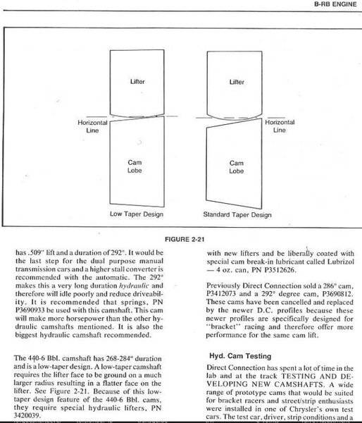

I think the taper was a little different on the 6 pack cams.

It appears to me that the lower taper creates a wider contact at the lobe/lifter interface to make rotation stronger or more posetive. sorry if im being captain obvious here.
if the low taper does in fact make lifter rotation better......then we must wonder why everybody hasnt been making them that way all along;especially in light of all the cam/lifter failures happening these days???
