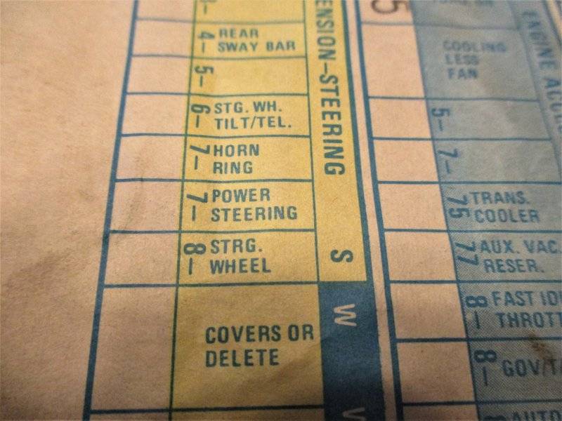

I'm in need of a new steering gear box on my '72 Roadrunner. It definitely is power steering, but I can't tell if I need to replace a factory power steering box or a conversion P/S box.
I got out my production broadcast sheet to see what my Bird originally came with. Does the absence of any numbers or letters in the check box mean that it came from the factory with manual steering?
Does the absence of any numbers in the check box mean that it came from the factory with manual steering?
More than likely does mean you had manual steering - or at least 'standard package' with the option group associated with the steering.
