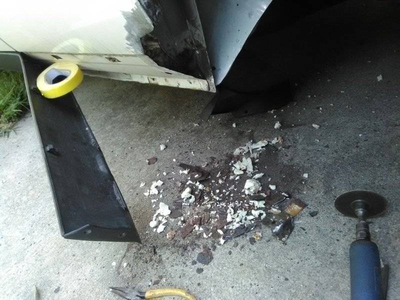

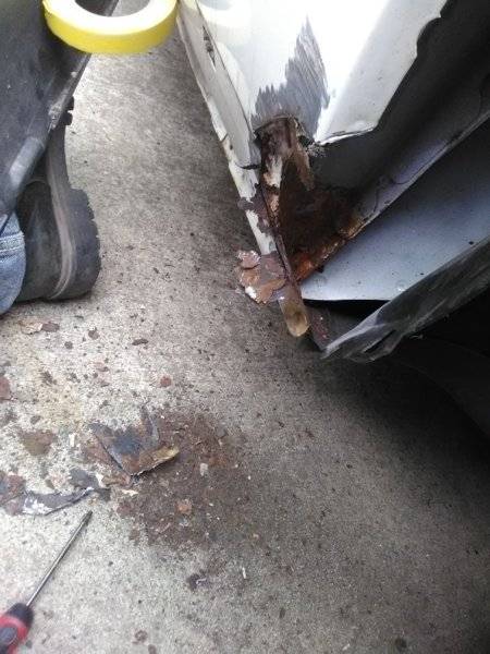

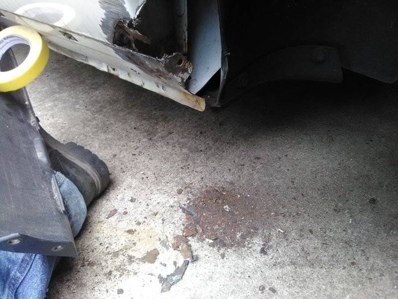

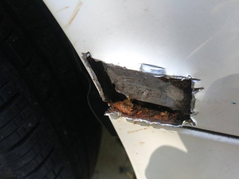

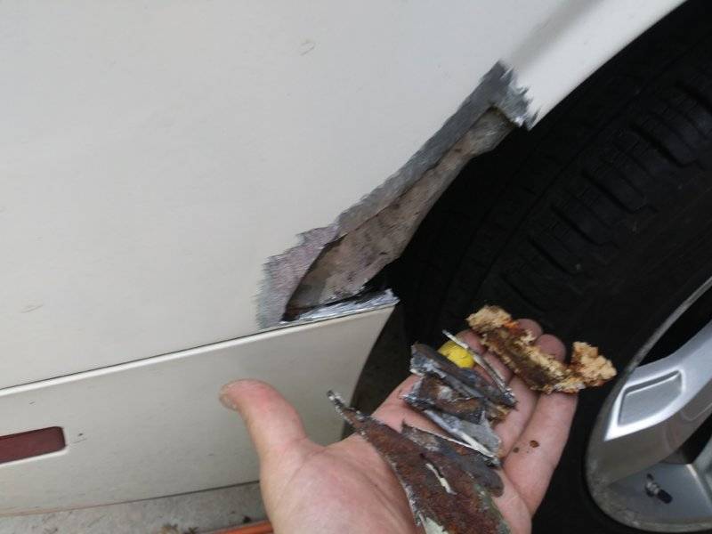

2010 challenger

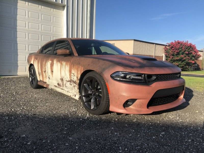

I have seen a newer charger with a rusted hood but I think a pissed off wife was involved with paint striper!

I'm not in the salt air....... these cars are filled with some type of Styrofoam, I suppose it gets and stays wet at the bottoms
There is a foam sealer in parts of the cars, it holds moisture and with that comes rust.
