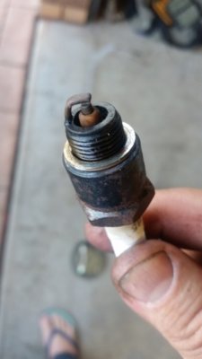

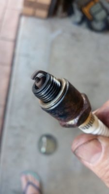

Do these plugs look ok?

Opinions pls...tia

Looks slightly lean, to me.
Others, with more experience with this new gas, chime in...
reading spark plugs doesn't work this way. Evaluation of street driving a/f ratio is much easier with a vacuum gauge and a wide band o2 sensor. In order to evaluate WOT a/f ratio and ignition timing, you need to start with a new plug, do one full power pass, and immediately remove the plug, then cut it open to see the base of the porcelain. Looking at a plug like the one in your hand with lots of street miles will not tell you much about a/f ratio or timing.

Looks pretty good for a “street” plug pulled out. ( that’s what they did KK!, as you well know). Not overly rich or lean. Replace with the same heat range, don’t touch anything.
Look good to me if they have been in there awhile . If not I'd say you need a different heat range if they have low miles on them
Alot of run time? Race? Street driving ? Alot of Factor's I have a car that has had the same plugs in it since the 80's they look brand new still . I had one that needed a new set once every 2-3 months

so what you see on your plug ,unless its pure black i would leave well enough alone.
is there a problem ?

A couple of thousand km since I've had it...and it cops its fair share of abuse on the street...has run a low 13 iirc before it came down under. Plugs may well be at least 5yrs old...
No problem, just trying to educate myself a little and learn more about the how's and why's ....
Do you use any octane booster or similar additive products? I only ask because the insulators look a little red-orange..timing looks to be advanced toward the max, how does it run? (It could just be the pictures playing with my eyes too...:D)
It's a bugger when cold but when it warms up it's great....when finished a cruise and putting back in the garage and put into park the revs go up about 3-400 rpm and then click back into drive it chirps the tyres...so it does need a little adjusting on the carbs I think...and it has a small hesitation just off idle when punching it.
Only used one can of octane booster since I've had it...will have to check timing.
I don't think that stuff hurts, just colors the plugs weird...as far as timing if it doesn't ping you should be fine
