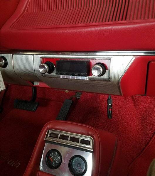

If you could recreate the original opening for the radio that'd likely be what I'd want to do. I had to locate a shaft-mount radio and Hermosa retro had one I installed. It has a lot of features I wasn't looking for; but added a power antenna as the unit accommodated. Only issue was the bezel and I have a couple of them so re-fabbed it to fit over the face and made an aluminum backing plate.
