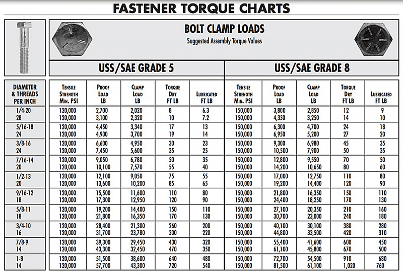

This makes no sense to me. Torque settings are when the threads and the head of the bolt are lubricated and slide against one another. NOT lubricating them is a good way to not get enough gripping power since the friction of the threads and bolt head reduce the effective torque, even though the torque wrench clicks and/or shows proper torque.
Basically, a dry bolt will drastically increase friction, and the torque required to tighten the bolt will increase, thus making you think the proper torque has been applied when actually, it hasn't. A bolt is tightened with oil not only on the threads, but under the head too to achieve the designed torque. Threads in the hole should be clean and chased too as any dirt or damaged threads will affect applied torque. I have never had an issue with thread locker, affecting torque, and just use the factory spec. I also use ARP thread sealer when bolts go to water, and use the factory spec too. The only case I am aware of is when using ARP Assembly Lube for their bolts/studs/nuts. The spec on the included instructions are for their included lube, but in the absence...
I have seen a chart for torque with their lube, and oil, but I can not find that currently. Their lube is a lot slippery, thus allowing the fastener achieve the clamp load sooner, and more consistently. If I find it, and will try to come back here and elaborate.
Example of dry and oiled threads:
Also, the torque applied needs to be the spec torque plus the running (rundown) torque.
As far as "Loctite" goes, call and ask them. They have tons of products...they might not recommend a torque reduction for some of their products.
