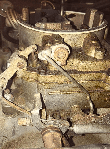

Hi, can someone recommend a good quality manual adjustable setting open/close setting choke cable? or electric choke? Link/part number would be helpful. I have a 68 charger 440 with carter afb 4137s.
I would like get the engine to idle on its own when cold. I have a manual cable but its hard to find the same "start" setting every time. It idles/runs great when hot but do not like having to rev it to keep it running when cold. I assume if the idle screw works when hot I shouldn`t touch it. There are two screws on the front but not sure if turning them would help.
I read roughly 9" vacuum at booster. What are some things I can do to get it to idle when cold?
I also have #3 inlet in the photo above plugged. Where should that go and would help solve my problem?
Thanks

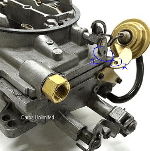

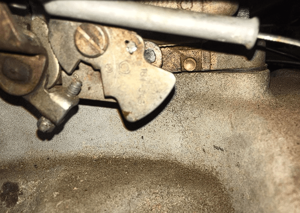

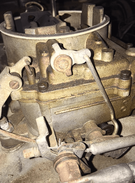

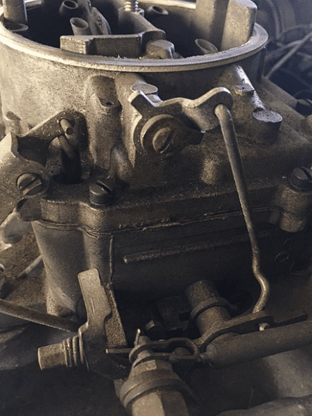

Hi, it might be my fast idle cam adjustment. It does not engage with choke almost closed and with tapping gas once. What could be issue? If someone has same carb that I could compare photos of the linkages with that would be great.
choke closed
choke open
I also assume #1 in photo is when fast idle is activated and where I adjust screw from?

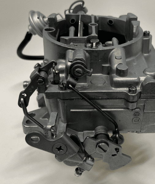

It looks like your choke rod arm is 180° off compared to this. The screw should be on the cam when closed and in the notch when open.
Yes I did fix that and now the fast idle screw sits on the index when choke plate is closed. But still cannot get the choke to "set" when depressing gas pedal once.
