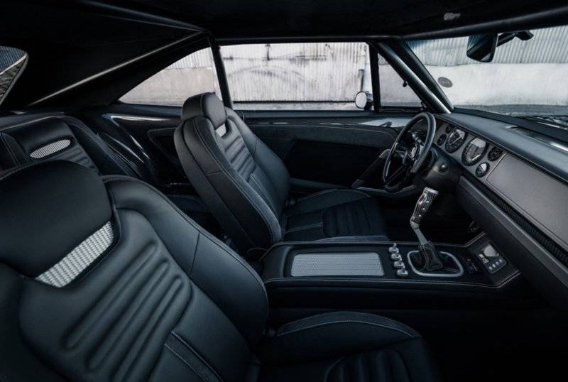

Hello guys, I am restoring a 1970 Dodge Charger RT. It´s going to be a mild restomod, 90% street, 10% track. I want to build a custom roll cage (pics below). It will add a safe factor, but I want it to be functional, letting passengers to enter and exit the car comfortably.
