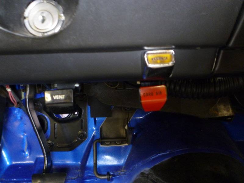

4speed cars had a reverse light on the dash. Auto’s did not.

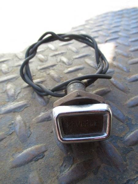

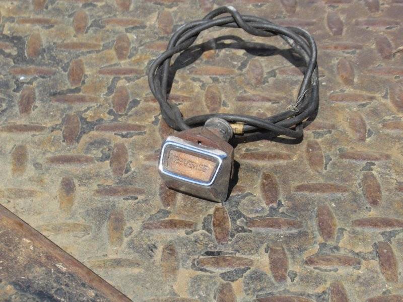

So is it this type of light?

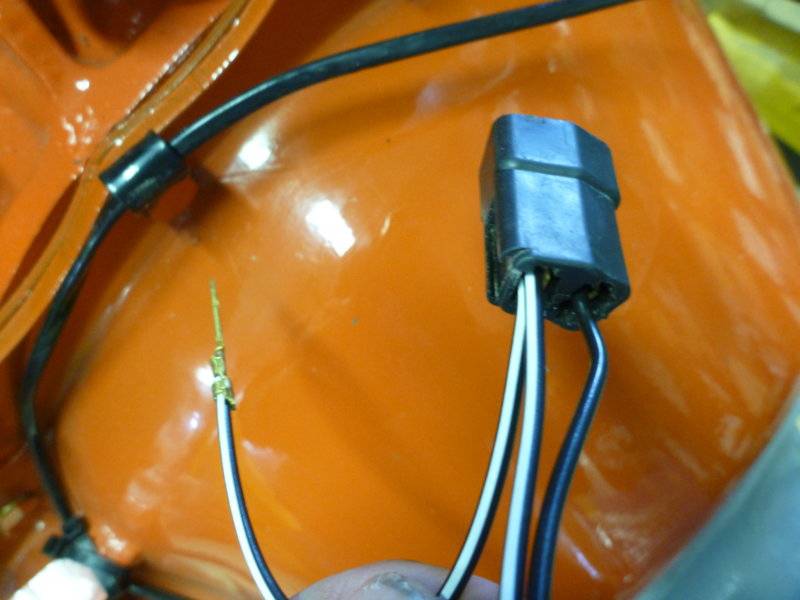

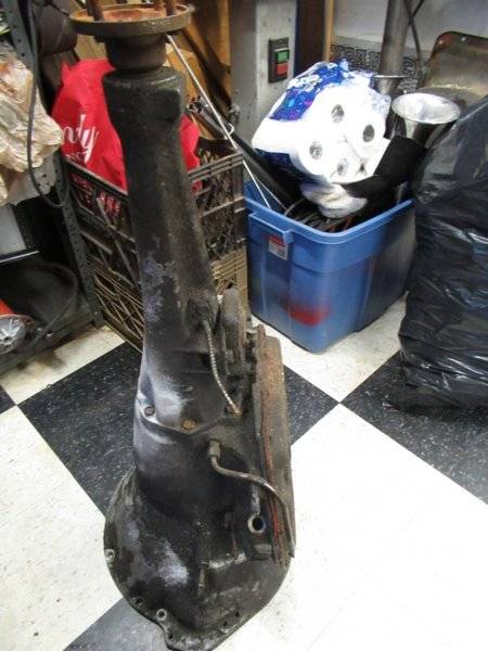

First picture wires to and from trans switch.

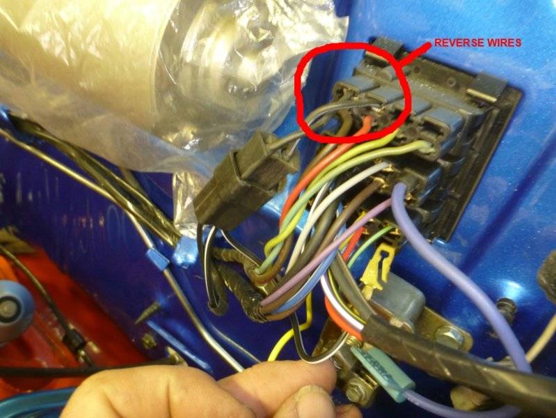

Second picture reverse light.

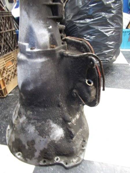

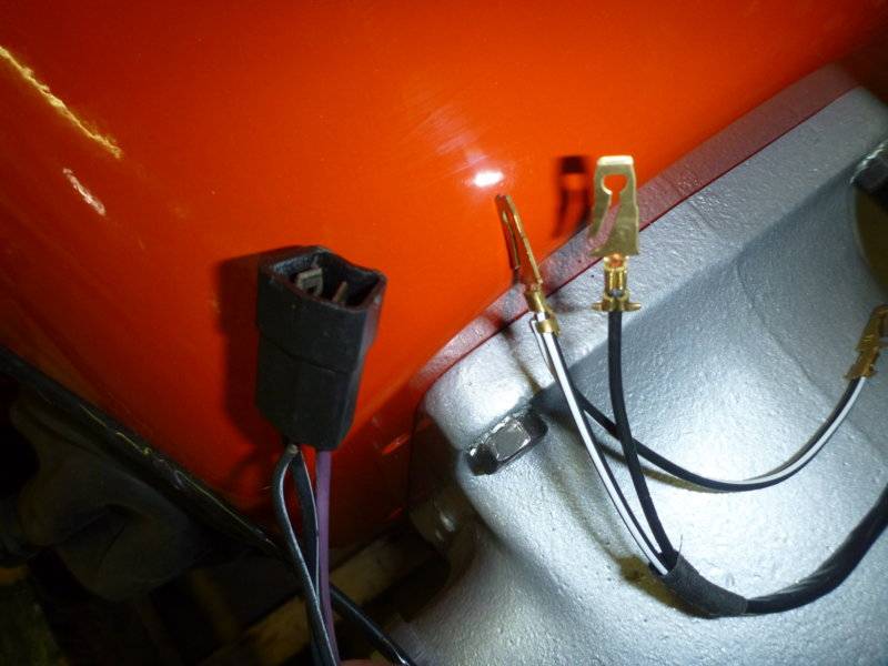

Third picture shows the connector and two wires to the "wiper" block, but note the third jumper wire, in my hand, that goes to the bottom right connection point for the + output to the dash light. "Wiper" block two wires are the power feed and return to the back up lights.

So are you saying there is a separate block with two wires coming off t wiper motor for the reverse lights?
Look at the third picture. That top strip connector to the firewall bulkhead connector IS the wiper motor harness. With a 4 speed you/they add the 2 wires and the connector shown that connects to the transmission switch harness that also has an extra pigtail off of it that goes where I show it in my hand (bottom right when facing the firewall). That "jumper" pigtail is the feed to the dash light. Most of these got "lost" in the early years the first time someone ripped a transmission out and couldn't be bothered to figure out how to disengage the pigtail wire from the bulkhead connector.
