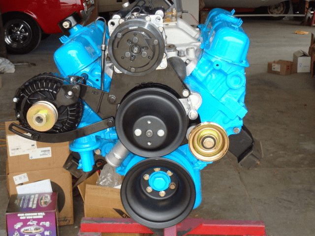

No. I went to Bouchillon. He had everything needed. Ill post a picture when I get home

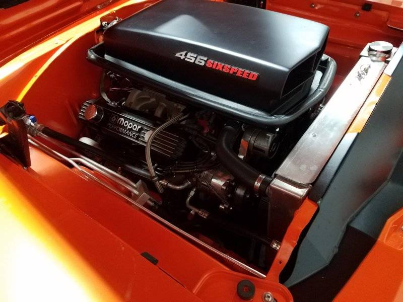

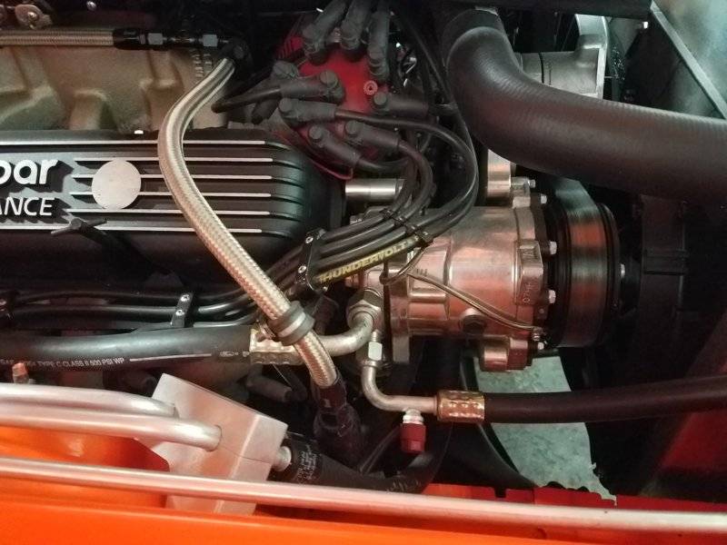

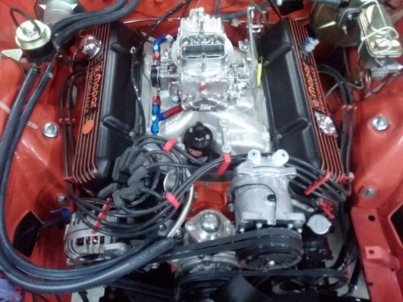

Here is mine. It's not "factory" but the car came with A/C and it now has it. The one picture didn't have the lines connected but now it is.

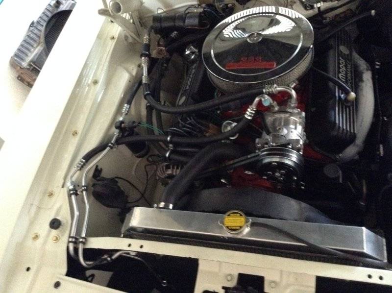

Azmoparboy

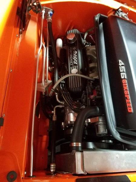

39F47562-A8E6-4AB5-8F86-F692DB71D3AE.jpeg 45AC79DB-E896-4A79-89E3-00C6C863A2CD.jpeg
Here's a few pics of mine, it's an SD Concepts serpentine kit as well.
I went with the Vintage Air system in my Dodge A100, and used Bouchillon brackets & pulleys for the engine side. It works great and I couldn't be more happy with the installation.

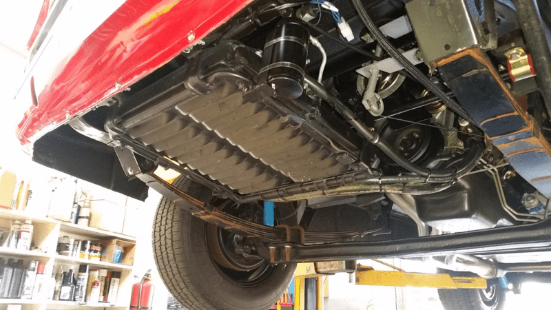

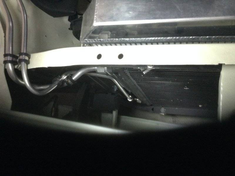

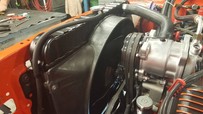

Biggest difference is that I used a condenser from a Toyota Van (cab over style)
I ordered the kit from Classic Industries.
Vintage Air dropped shipped to my house.
So far, everything looks okay, but I have not started to remove the old equipment.

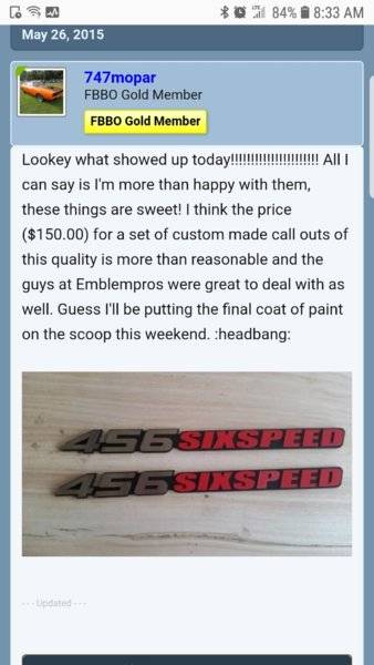

If you don't mind me asking, where did you get the custom emblem made?
If I remember correctly these guys are Vets, really good guys to work with. I sent them a drawing of what I wanted drawn to scale, I was pretty happy especially for all that it cost.
