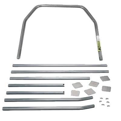

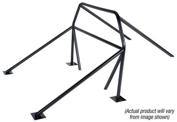

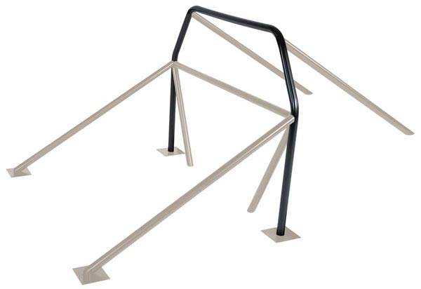

Maybe Competition engineering
C3127 for 68-74 RR/B-body 8 pt rollbar
or ? C3000, may just be the main hoop/bar
I saved them a long time ago
I can't remember which is which or the costs
good luck

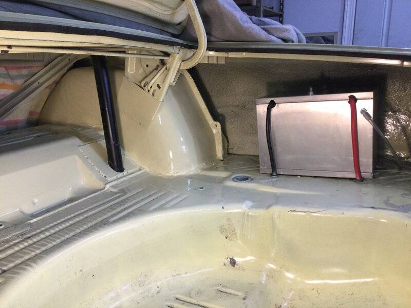

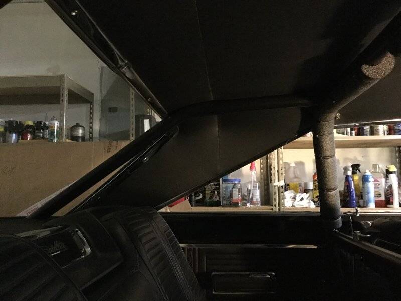

Nothing you buy pre-bent is going to impress you, fit-wise. Every time I see a bar with the rears in that pre-bent shape that doesn’t follow anything in the car it makes me cringe. You’re going to have to look at it EVERY TIME YOU GET INTO YOUR CAR.... Do it right. Make a template of the angle / shape in cardboard. then take the kit bars to someone that has a mandrel bender and mimic the template. I had mine custom bent, it fits the roof / rear window really tight. The only regret I have is that they fit so tight that I can’t get a spray gun back there to touch up the scratches I put in it at install.
View attachment 1064487 8ACD2CE4-1847-4C60-A16A-16BB627D0FBC.jpeg 3D70FB8E-62AE-45B2-8B55-4F06BEA028DE.jpeg

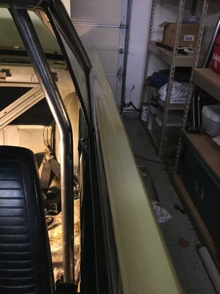

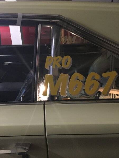

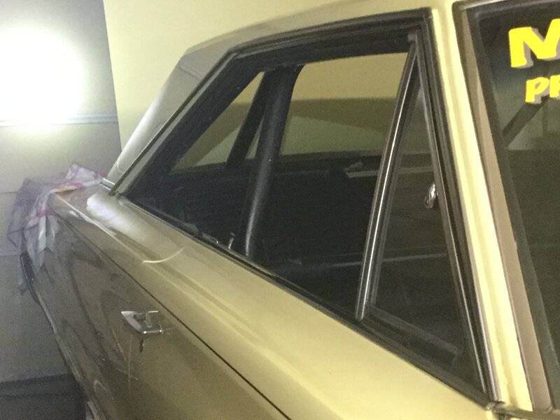

My main hoop is from an Art Morrison Kit. I was pretty happy with how it fit the roof and side-glass lines. I installed it at the same angle as the seam in the front to rear side glass, so it follows the lines of the car as well as I could have hoped for. I’d buy from them again in a heartbeat.
76A08260-56CD-4DD7-9236-0DCD23FC8041.jpeg E2C75F33-6763-4DE7-B8CA-740C3B389D93.jpeg 29158E79-8BEC-45A0-BAB3-000FBD446AEF.jpeg
