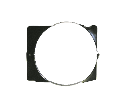

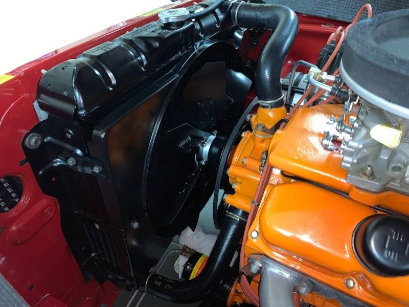

The shrouds usually came on A/C cars They are a two piece metal affair that bolts together. They attach to the radiator with four bolt-on brackets. Not all 22" radiators of the day had the slots in the side straps to accept the brackets. You pretty well have to find a rad with the shroud on it. The metal shrouds and brackets are being reproduced.
